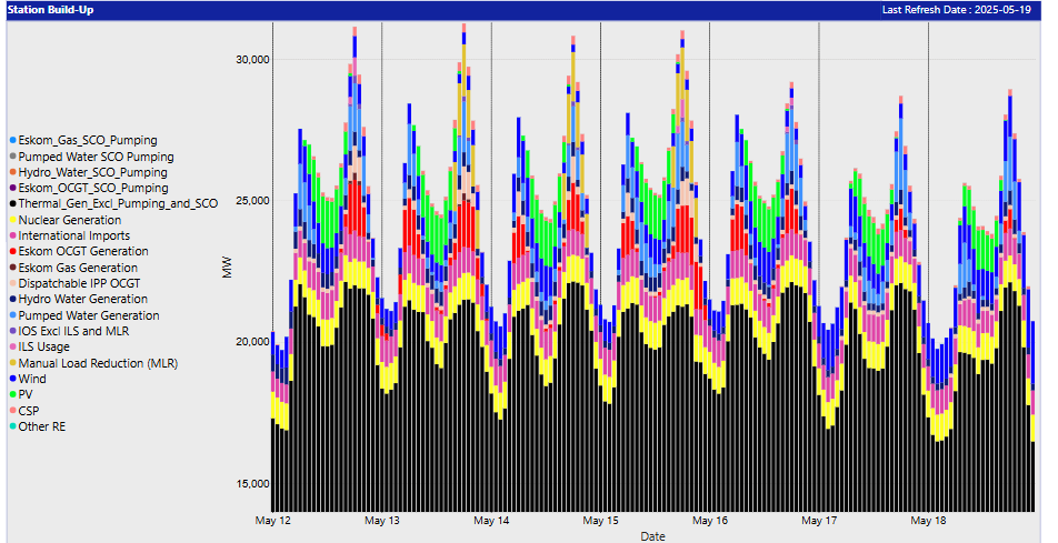

    Looking at graphs from last week and the start of stage 2 during evening peaks - It is clearly an impossible task for Eskom to ramp up for such peaks .
    It would appear that we could have a fair amount of evening stage 2 load shedding scenarios at short notice

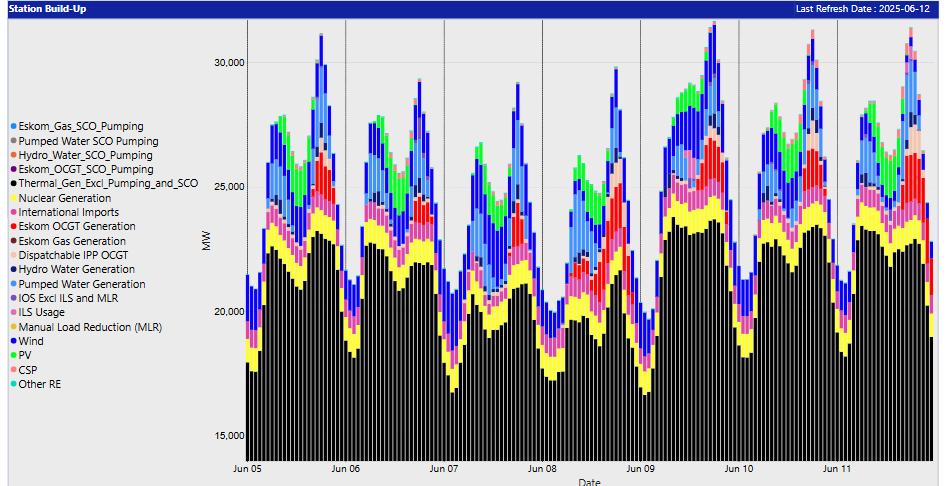

      Looking at graphs this past week showed an interesting coal usage - Eskom managed to do quite well on Monday when the complete country was basically under cloud but with the lack of the "V" shape on the graph it just shows how much roof top/private solar there is out there .
      Still don't understand how we have not had load shedding in the evenings as they running diesel in all the peaks even on the weekend
      Can only be due to elections next year that they are trying to keep people happy

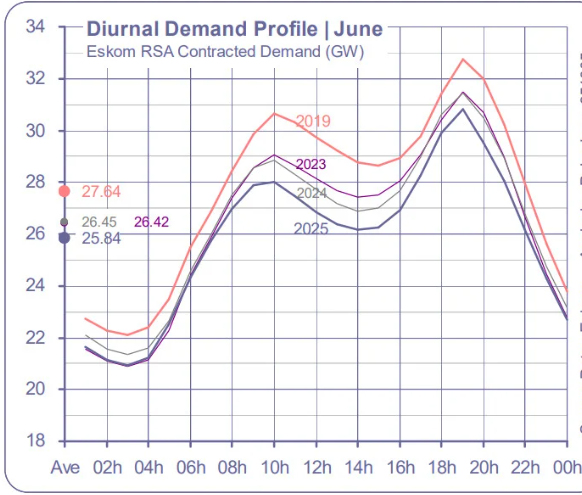

        • 1484

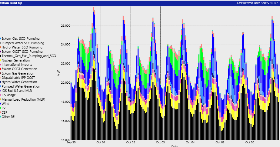

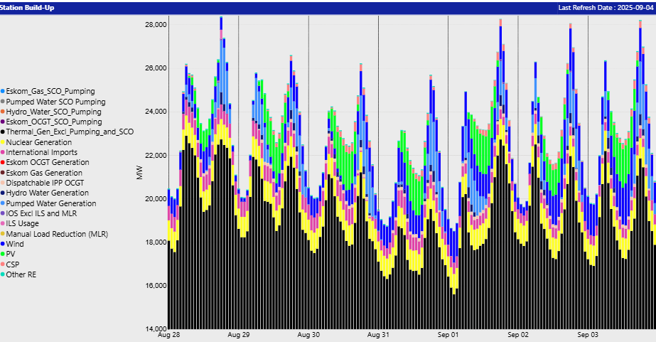

        Read an interesting article this morning an how Eskom are shooting themselves in the foot .
        Eskom keep telling us how great they have done to reduce load shedding - I look at the graph for the past week compared to what they were doing last year and there is a massive drop in demand/usage
        Pasted Sep and Oct below and was interesting comparing to previous graphs posted previously in this post
        Click image for larger version  Name:	2025-09-05.png Views:	0 Size:	90.1 KB ID:	323780
        Click image for larger version  Name:	2025-10-08 (2).png Views:	0 Size:	90.4 KB ID:	323781

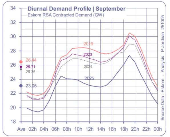

          • 1484
          The article had 2 interesting graphs showing the reduction of demand over the past couple years - This shows that it is not Eskom that has improved but the amount of roof top solar systems that has been installed which has saved load shedding
          Click image for larger version  Name:	2025-10-08 (1).png Views:	0 Size:	191.1 KB ID:	323783
          Click image for larger version  Name:	2025-10-08.png Views:	0 Size:	199.0 KB ID:	323784
