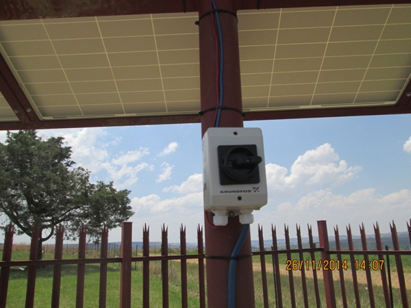

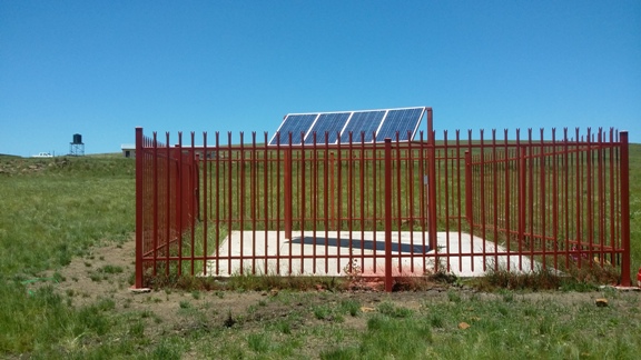

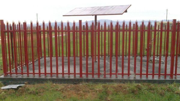

    Could anyone tell me if I need a CoC on the following installation?
    A few Solar Panels connected in Serie, connected to a On/Off Switch, connected to a Borehole Pump.
    This is the description that I got from a friend.
    The installation is on a farm on a area with no power grid, hence the solar installation.
    No batteries, no Inverter, no Charger controller.

    The pump is a 3" Grundfos SQF Pump(Solar powered pump) and it seems like it is connected directly to the switch, which in turn is connected to the Panels.

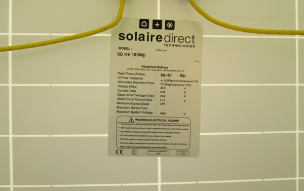

            Lol, I just saw now that you got two conflicting answers but I'm guessing Dave didn't see the spec sheet in the third photo. Voc = 44.2 Volts. It's classed as ELV and from the reg Dave pasted above would fall under exclusion D.
            (d) control circuits of 50 V or less between different parts of machinery or system components, forming a unit, that are separately installed and derived from an independent source or an isolating transformer and hence wouldn't be classed as an 'installation' for purposes of Coc requirements.
            I don't think it's a bad thing to certify the system but I don't believe it's an actual requirement that it must be certified. That's just my opinion and I wouldn't be surprised if Dave has something up his sleeve I might have missed.
                    I know this is a very very old post, but though I'd chip in: Those 3 solar panels are probably all setup in series, giving roughly 108V, which will then most likely mean a COC should be given.
                      Those Grundfos pumps can run as low as 30 volts DC voltage range so the panels could be either series or parallel if they're connected direct to the pump with no charge controller.
                      **edit** Scrap that last statement, just re-read the whole thread and I didn't previously see that he stated the panels are in series in the opening post.
