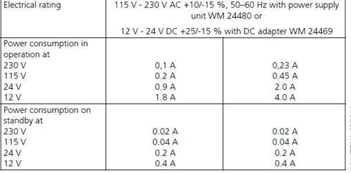

    I am not an expert in the field (I actually know very little – I know how to connect a plug). I have sleep apnoea and have to sleep with a CPAP (Continuous Pressurised Air Pump) machine. My problem is I cannot go on holiday to places where there is no electricity available (and that is the places I would like to go to). Can anyone suggest an “affordable” solution to this for me?
    I want to be able to charge the device using either Solar or from my car cigarette lighter socket.
    The following is the information I find on the documentation of the CPAP machine I am using with respect to electricity usage
    (Please note I do not have the 12V DC adapter and I am not sure if it is available in South Africa)
    Electrical Rating 115 V – 230V AC +10/-15%, 50-60 Hz with power supply unit WM 24480 or
    12V – 24V DC +25/-15% with DC adapter WM 24469
    Power consumption in operation at:
    230V 0.1A 0.23A
    115V 0.2A 0.45A
    24V 0.9A 2.0A
    12V 1.8A Without Humidifier 4.0A With Humidifier
    Power consumption on standby at:
    230V 0.02A
    115V 0.04A
    24V 0.2A
    12V 0.4A
    Please ask if you need more information

      Your data shows that at 12V it draws 4Amps. This is a total of 50Watts. If you run for 24 hours, you need a reservoir of 1152Watts.
              230V 0.1A 0.23A
              115V 0.2A 0.45A
              24V 0.9A 2.0A
              230V 0.02A
              115V 0.04A
              24V 0.2A
              12V 0.4A
              Do you need the humidifier to be on? There's a big difference in power consumption, it uses less than half the power if the humidifier isn't needed.

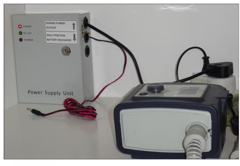

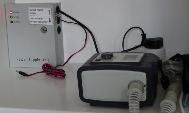

                      • Gerald Schaffer
                        • May 2019
                        battery backup
                        Sorry, no, it runs of mains
                        I know it is a long time since your query but I had the same problem and had a battery system made to suit me. No inverter. You say that your machine can run on 12V so why invert? During load shedding I have a 12V battery running my cpap machine (Phillips Respironics) for over 6 hours (tested). I did try and buy a commercial battery unit but was not satisfiedClick image for larger version
ID:	265644 that it was what I needed and the cost was high.
                        • Gerald Schaffer
                          • May 2019
                          This is my setup. The battery pack was made in Cape Town and does not use an inverter. I have tested the battery pack and it runs my Phillips Respironics CPAP machine for over 6 hours before the drop in battery voltage causes it to cut out. This is more than enough for use during power outages which have been 2 to 3 hours.
                          There is no noise as with a UPS.
                          It is comparatively small and the cost is reasonable.
