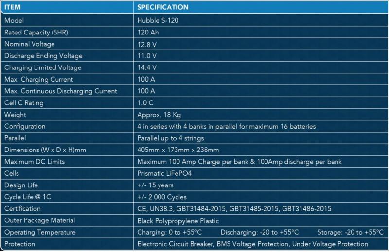

Thanks for the advice i did manage to find a manual for the Microcare inverter and did speak to the technical guys at Microcare in PE. The parameters could be set up for Lifep04.The main challenge in charging a Li-Ion battery is to realize the battery's full capacity without overcharging it. Constant current constant voltage (CCCV) I will set the inverter cut off voltage at 40% dod.

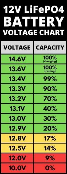

Voltage per cell, I think your battery has 4 cells in series
Minimum discharge voltage = 2.5 V = 10V
Working voltage = 3.0 to 3.2 V = 12V to 12.8V
Maximum charge voltage = 3.65 V = 14.6VVictor - Knowledge is a blessing or a curse, your current circumstances make you decide!

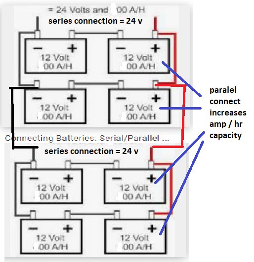

Thanks guys i appreciate the guidance and info. The ac load is 25amps single phase on inverter output and these new Lifep04 will be much more efficient than the 120ah deep cycle gel batteries so my thinking was to discharge only to 40% dod for the longevity of the battery bank as the client is paying R160k for the new batteries i have enough capacity to run down to 40% dod (24 batteries@120ah/battery) series/ parallel for 24v dc inverter input. I see on the existing installation there is 1x class T 30 fuse installed as primary disconnector on the positive side at the inverter or would it be better to put fuse protection between every bank and leave the class t fuse as main interrupter. I also see that this inverter can run at 200% 16kw if mains is present. There is also a ats changeover switch installed for a 30 kva diesel generator with one fase and neutral feeding the inverter. I was also thinking of using copper busbar with short leads to the battery terminals and get rid of the 16mm welding cable making the installation looking very untidy or am i overthinking the setup.Comment

LiFePO4 have life cycles from 2,700 to over 10,000 cycles depending on conditions, so there is no advantage making the DOD at 40%.Victor - Knowledge is a blessing or a curse, your current circumstances make you decide!

Not lower than 10 % and not higher than 90 charge is a good average ? I am told some batteries have built in 10 % compensation, so going from 100 % to 0 % is not an issue.Comments are my opinion, unless regulations are attached to support the comment. This is social media, not a court room.Comment
