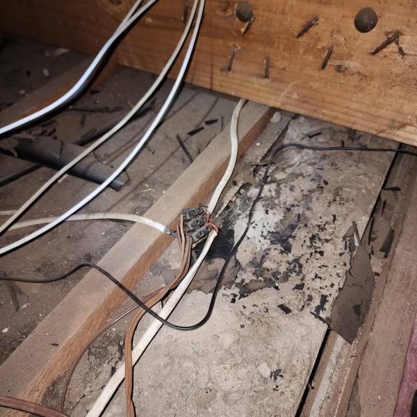

    I have recently moved into a new property, and after a few weeks noticed a dead short/ sometimes just not working on one of the wall sockets.
    I also had to crawl around in the roof, to install new network cables to evenly distribute wifi and network connections between all the devices and my router.
    I notices allot of shoddy open connections, with either no junctions boxes (only chocolate block) or connections within junction boxes with no lids/covers or glands protecting the connections from strain.
    One of these uncovered metal junction boxes are right next to my geyser (with the geyser being connected with a bunch of ppr pipes)
    There is also allot of cabtyre and twinflex wire being used instead of flat twin+ earth.
    I contacted and paid for a report and fault-finding exercise from another registered electrician.
    But right now, i find myself in the middle of a he said she said, "I didn't install that, show me the regulations back and forth.
    Would you guys be so kind as to comment and recommend a course of action. And potentially point out the Sans regulations pertaining to these connections (for or against)
    Are these open connections with chocolate block and no junction boxes allowed on Sans 10142, and are the use of these junction boxes only considered "good practise"?
    Or are there grounds to contest this COC?

    The joint in the photo is illegal and the twin flex coming out of the mess will not be suitable rated at 230v besides that fact that there is no earth
    If the COC is done by an ECA member you could take it up with ECA alternatively you would need to report through the Department of Labour or contact and employ an AIA do take the case up for you .
    Extract from SANS 10142-1 below
    6.3.7 Joints and terminations
    6.3.7.1 Joints and terminations of cables, cores and conductors shall be
    made in accordance with manufacturers' instructions or the appropriate part
    of SANS 10198-10 and SANS 10198-11.
    Flexible cables shall only be joined using termination boxes, cable couplers or
    manufacturers’ jointing kits.
    All joints shall be accessible, protected against strain, and protected in
    accordance with 5.2.1, except for joints made and sealed permanently and
    intended to be maintenance free.
    5.2.1 Live parts
    It shall not be possible to touch any live part within arm's reach with the
    standard test finger (see SANS 60529)
    a) during normal operation, or
    b) when a cover is removed, unless the cover is removed with the use of a
    tool or a key.

              As you can see from the photo, bootlace crimp ferrules was not used.

                    There is twin flex used - which is a definite no - Also no cabtyre under 1sqmm
                    6.1.11 Where flexible cords are used as part of the electrical installation, the
                    selection, installation and colour identification (see 6.3.3) shall be done in
                    accordance with this part of SANS 10142. Flexible cords with cross sectional
                    area less than 1 mm2 shall not be permitted.
                    6.1.12 Where flexible cords are used, the strands of the conductors shall be
                    mechanically protected with ferrules to prevent the strands from being cut off
                    in terminations.
