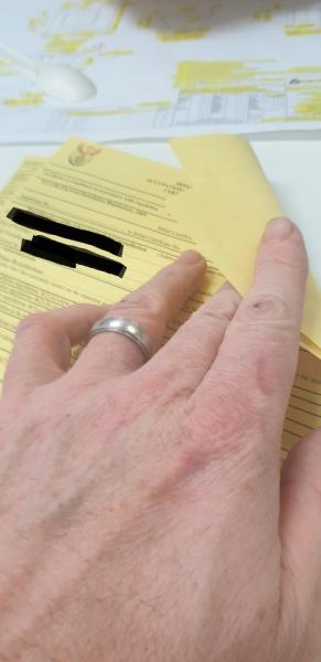

    1. Although both pages are yellow, and seems to have the right emblems on etc.
    The only problem i have is that in the past i have been given a COC in booklet form, and these are two separate pages that are blank at the back.
    Is this a legitimate COC form? See picture attached.

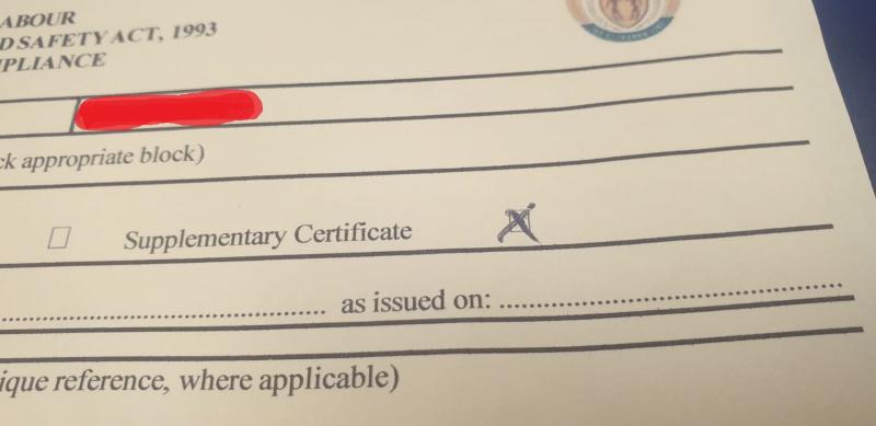

    2. On one of the pages the supplementary box is ticked. Surely when this is the main COC that is handed over to the bank and to the insurance and to the new owner, this
    has to be a standalone document, and somebody coming to install a separate piece of equipment then fills one of these supplementary COC's in that has to be attached to the main one.
    Is this valid, or must i insist on receiving a proper COC where the supplementary box hasn't been ticked? Despite all the electrical faults and noncompliance wiring that has been plaguing us during this progress!!!
    See picture.

    1. Not being able to see the whole form, it is difficult to say if the blank form is legit or not.
    The form does not need to be yellow, neither does it have to be printed on both sides.
    If it is in the format laid down by Dept of Labour and section 8 in SANS 10142 then it should be acceptable.
    Note: Here we talking about the blank form only.
    2. Supplementary box ticked.
    Supplementary COC's need to be attached to the main or initial COC.
    In my opinion, the property should never have been transferred into your name without a valid initial COC.
    I would take this up with the transferring attorneys.

      Thx for that. Even though the supplementary box is ticked. All the light fittings, plugs , gate/garage motors and aircon is listed.
      So i dont know how it can be suplimentary when everything is listed.

                  The supplementary box might have been ticked on the first page, but the second page list all the circuits and motors etc.
                  This was handed over explicitly being advertised as the MAIN COC. Everything is listed. So im still not clear on the question whether the supplementary tick
                  somehow invalidates this as being the main COC. Please advise.

                      I would insist on a COC marked initial.
                      Should you, in the future, have an insurance claim, the chances are good that the claim will be rejected if this COC were produced.
                      Another thing is that any corrections made on the COC will invalidate it, so a new one needs to be issued. ( I waste quite a couple )
