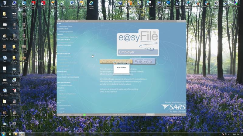

                One thing I have noticed and I dont know if you can see it from the screen shot, but this is what comes up when I dbl click the easyFile program. I haven't lodded on yet, but it si showing as connected ? Any thoughts.

                  Hi ABDurbs - the fact that you are connecting makes me think that it is not the AVG anti-virus. Are you using a specialised firewall, as that can also sometimes cause problems.
                  If SARS finally sorts this out for you, you must come back and tell us what the solution was, as I would love to know - and it will also be very useful for others who might find themselves in the same boat.
