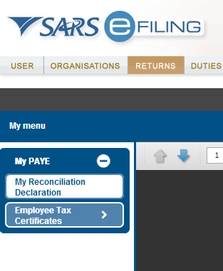

                        First you generate an EMP501 and you will get a message in a popup telling you you must use either easyfile or efiling, not both, and that you can generate up to IRP5's or IT3's
                        Then select continue at the bottom of the box, and you will be presented with a 501 declaration on the screen. On the left there are two options:
                        Click on employee tax certificates and then do the necessary

                          Thanks... but you can only do this if you have a PAYE number?
                          • CLIVE-TRIANGLE
                            • Mar 2012
                            • 886
                            No, it is the tax number.
                            I must say though I registered them some time ago. I don't currently have anyone requiring it.
                            I spoke with my partner earlier this morning and he did one as recently as last week. If anything more comes to light I will post it.
                            • Christel
                              • Feb 2012
                              • 361
                              Thanks Clive- this works 100% with the income tax number.... !!
