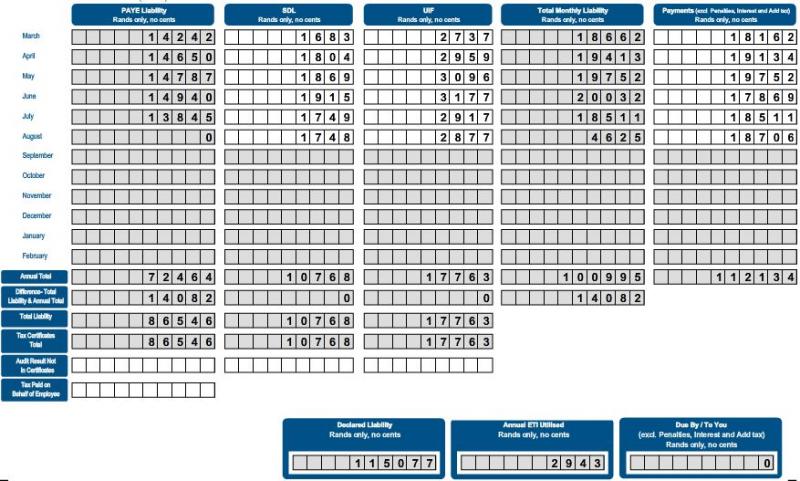

                      I really don't understand how I manage to invoke the strangest bugs.
                      I import the data from SARS, and it fails to populate August in both companies.
                      So in one I can update the August info no problem.
                      In the other, the PAYE column is greyed out - I'm not allowed to enter data. See below -
                      Despite this, it still manages to figure out I don't owe any money
                        Hi Dave A - I think that you have to go to the previous screen (page one) to be able to enter data.

                          Yes, I agree, maybe you have ticked the ETI on the return, then it does not allow you to enter the PAYE on this screen. Just un-tick it on page one. The Aug figures does not pull in at all. Not sure how they update their systems, maybe it will also take 21 days....

                            It looks like you're on the right track. The challenge now is it's kinda hard to recon the ETI claim if you don't tick the ETI box...
                            Well done SARS.
                            (Of course they'll claim it's working as designed).
                            • Christel
                              • Feb 2012
                              • 361
                              Ai Dave... then you just manually complete everything and don't use the SARS import.... Easy peasy
