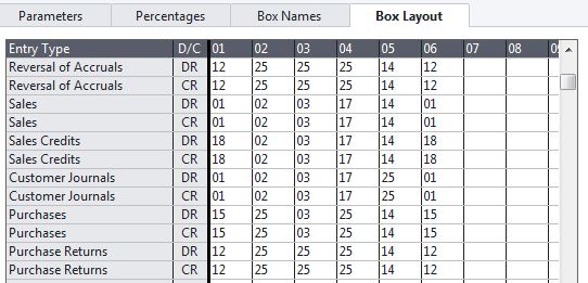

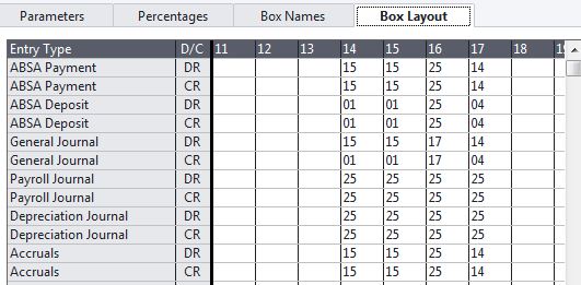

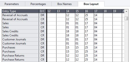

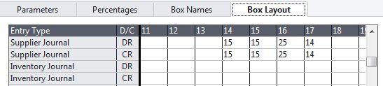

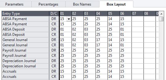

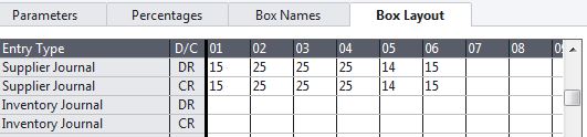

      thank you, this does help, are you able to also maybe send me a screen shot of the box layout specifically the purchases DB and Cr ?? if you wouldn't mind.
      • Mike C
        • 2894

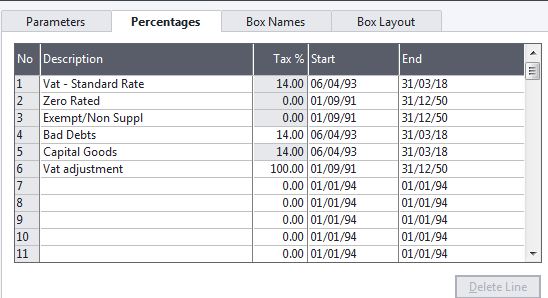

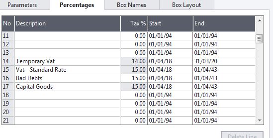

        Hi thorpie.
        Here are the Percentages:
        • Mike C
          • 2894
          And here are the box layouts:
