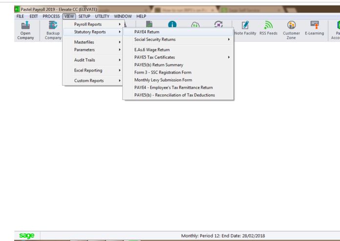

                        • LizaC
                          • Sep 2017
                          • 13
                          Hi Mike C
                          Ok I tried what you listed. There is unfortunately no IT3(a) and IRP5 Checklist under Statutory reports. Click image for larger version
                          See attach image these are the options I have

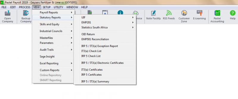

                          • Mike C
                            • 2893
                            Hi LizaC - I can see why you can't find it. I presume that your Payroll has been set up for another country, and that is why the Statutory report is different.
                            This is a screen grab from my laptop.
                            • LizaC
                              • Sep 2017
                              • 13
                              IRP5 FOR WINDHOEK
                              Ok, so I am not being silly and overlooking. Yes I am indeed running payroll for another country. We run for Windhoek, anyone with experience here...please advise. IRP5 run
