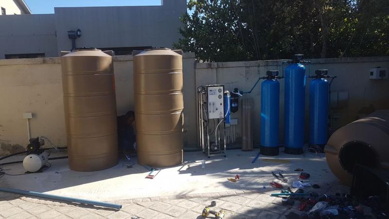

        Hi guys.
        Here are some photos of a static filter system to remove iron from borehole water that I saw the other day. A very nice looking setup costing the client over R60 000.00.Apparently they are going to add on two more birm filters at R 18 000.00 each ......yo
ID:	265443Click image for larger version

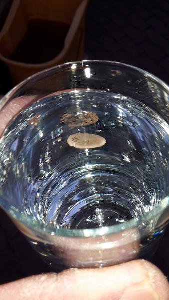

        Does not look like the iron is out at all.

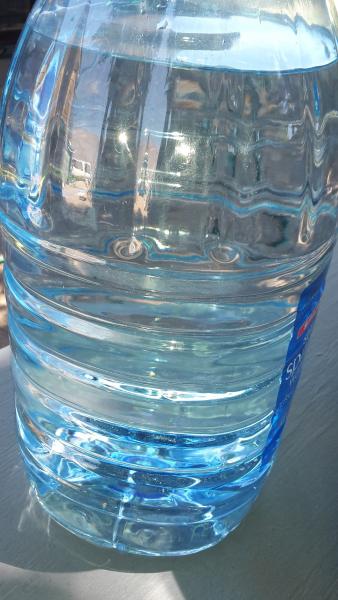

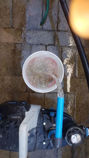

        With our Mini Water Treatment Plant the quality of the water looks like this.
ID:	265445Click image for larger version
        At half the price !!!!!
        These static filter systems are a ripoff.

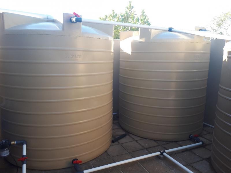

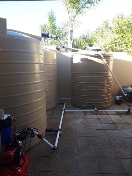

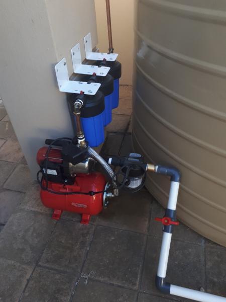

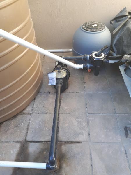

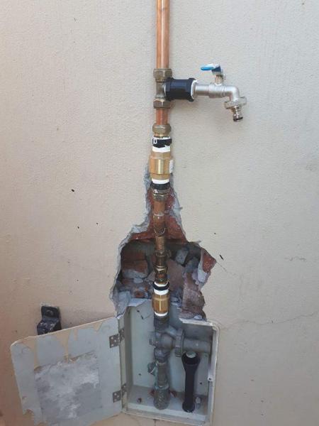

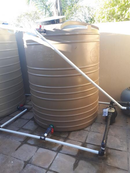

                  Just want to thank you again for all the help you gave on setting up my water treatment plant. System works great with first lab result confirming that there is zero E-Coli and Coliforms in my treated borehole water with the chemicals you suggested. I am still waiting for my other lab test from Bemlab wrt heavy metals and other metals in solution but with my TDS below 500 I am 98% sure it will be safe for human consumption. Find attached some pics of my installation. All told it cost me a tad over R33K but one could get away with smaller tanks and no Big Blue element filters( I just added the Big Blue as insurance). The installation itself is not very complicated and if one is handy you should have no trouble with the DIY option, I just refuse to pay someone R10-15K to do something I can do.

                    sorry I forgot to mention that I also installed a 85W UV tank lamp on the 2nd tank(5000 ltr secondary treatment/holding tank). I also have a venturi in my 2500 ltr tank which operates as I am filling the tank thus aerating the borehole water to help oxidise the iron in solution. Also I have a little(800 ltr per min) fishtank airpump which I will be installing into my 2nd 5000 ltr tank(primary holding tank connected to point of use). To avoid contamination of municipal water I have fitted 2 x non return valves and there are x3 stopcocks in line to seperate my treated borehole water to that of the municipality. In fact my pH is much better than municipal water.

                      Great job Craig. Can you please post a pic of the venturi. Do you mind sharing where you bought the it?

                        Hello Craig
                        Looks very professional. When I google Big Blue element filters, I get various results, can I ask where you purchase these filters?
                        • CraigH
                          • Feb 2018
                          • 5
                          #42
                          Big Blue Filter system
                          Originally posted by rh1
                          Hello Craig
                          Hello
                          The best price in town will be from Mike at Cape Garden Centre in Joostenberg Vlakte. I got mine at Bergrivier Besproeiing in Paarl

                            Hi Tarmac
                            I made my own venturi with 2x 40>32 reducers(PVC weld type) and a piece of 20mm conduit but you can buy ready made venturis at Koi fish shops or at Effast in Stikland
                              #44
                              Great looking setup, your plumbing is much neater than mine
