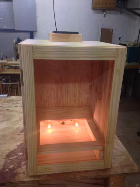

                        My biltong dryer, just have to fit the glass panel to the front door.

                          Nice Ian!, looks tidy. When will you be making your first batch?
                            #28
                            I was going to get a mix from Dirks in Davenport and some meat, put a piece of tin foil in place of the glass but unfortunately I only finished doing my paperwork and filing late this morning. I worked the whole day yesterday into the night and this morning filing 2013 documents. Tomorrow I have to start real work otherwise I am going to go bankrupt.
                            I will collect the glass, meat and mix tomorrow and hopefully load the dryer in the evening.
                              #29
                              Some of the features, a slide out drawer which you wrap tin foil for drips which you can replace
                              4 leaver switch to control the 3 lights and the fan...so if you don't want lights or the fan you can switch off.
                              A removable back panel to get to the wiring...pity only when I finished gluing the wires I realised I had to fit earth wires because I used brass lamp holders, so it looks untidy. Next time I will use plastic or porcelain lamp holders.
                              I only drilled the holes for the vents after I took the pictures they are at the bottom left below the tin foil and there is a gap between door and the shelf for the tin foil
                                #30
                                it looks well made "unlike my piece of plastic" What was the total cost?
