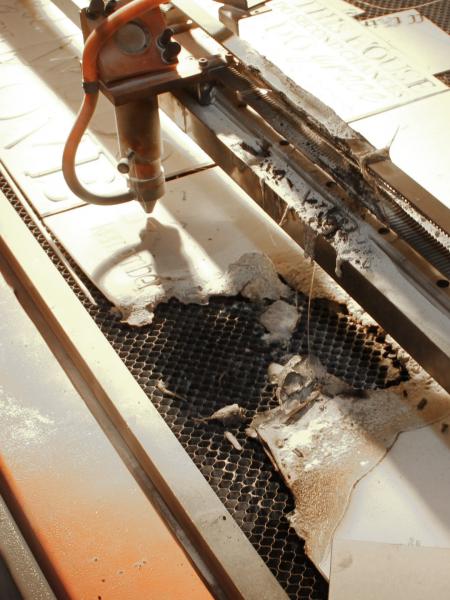

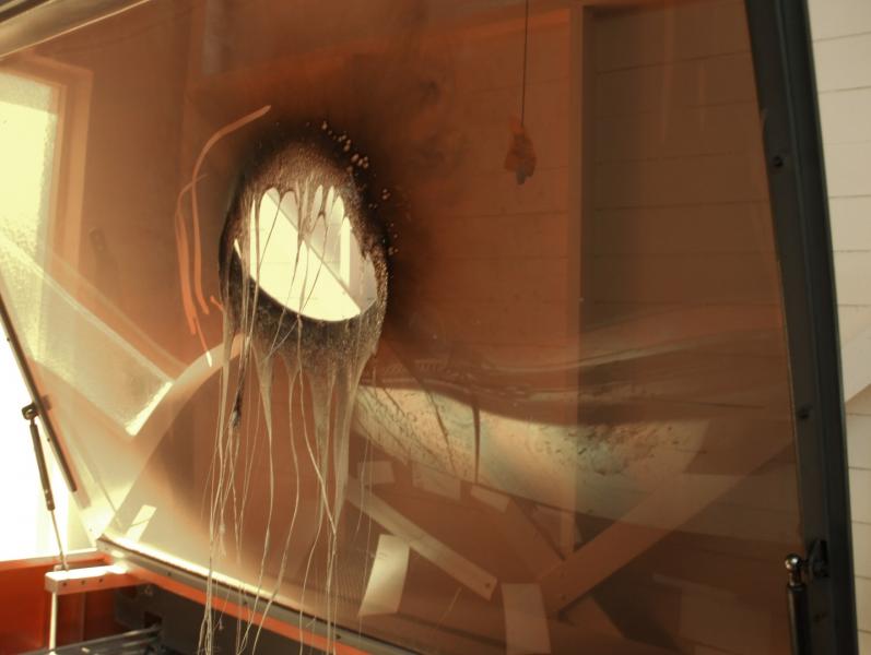

    So, Monday morning starts with a bang. A customer phones at 7H30 and totally does her nut. It's F*ck this & F*ck that and your service is sh!t and and and...I think that she must have a terrible hangover from the weekend. Then another customer arrives and we spend a couple of hours trying to see why the one laser doesn't cut 100% all the time but only 99.9% some of the time...
    ..and lo and behold...one staff member comes running in, smoke billowing as he opens the door, and tells us that the other laser is on fire....uh...ok...thankfully my Zim guy had the sense to hit the emergency stop and put the fire out with the dry powder fire extinguisher.
    What did we learn today...
    1. Monday sucks!...but then we all know that!
    2. Sh1t happens very quickly.
    3. Never leave a machine unmanned... (thankfully the one laser is in the same workshop as the staff and the other laser is right next to me)
    4. Don't mess around when it comes to fire safety....That fire would have burnt the entire place down in no time at all if it wasn't for Samuel and the fire extinguisher.

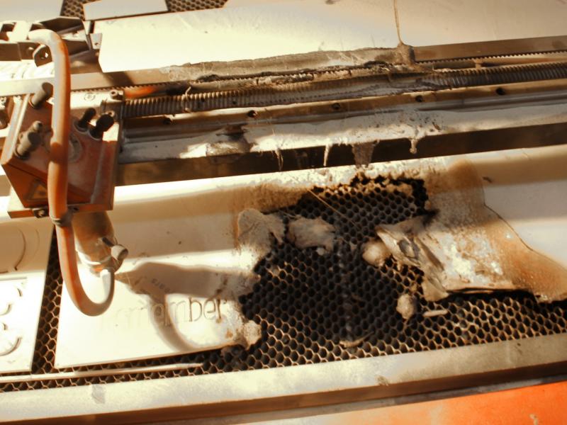

    That is horrible, I hope you can salvage that. I have spare belts for my laser that you can use if need be. I hope nothing warped your frame and you can still get focus once you have cleaned up.
      The guys put the fire out fairly quickly so we're lucky in that regard.
      I've more or less cleaned the machine. The belt is a write off and so is the air pipe. I haven't looked at the lens but I'm sure it will be fine. I'm sure I'll be able to get a belt from one of the local suppliers.
      It is amazing how quickly it caught alight though. I never gave fire much thought. I've cut myself a couple of times and I always just shrugged it off.
      A lesson for me in vigilance....I am damn lucky because I often left the machines running unmanned...never again!

                    Ian, the fire was entirely my fault. The laser tends to flash back off the grid and make marks on the underside of the job. I put spacers in between the grid and the 4mm Plexiglas to stop this from happening. The spacers were largeish blocks of 2.3mm chipboard. Doing this worked quite well but this time I turned the speed down and cut quite slowly to make sure that the laser cuts through first time. I think the combination of low speed, high power, hot Plexiglas, hot chipboard and no airflow was the cause.
                    The lesson of course is if one uses spacers to make sure that they still vent well and also that they do not add to the heat generated by the cut. ...we live and learn!

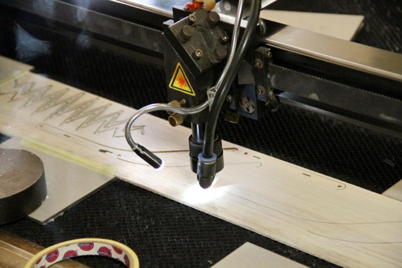

                          Here is a bright idea for you. I always found it very hard to see exactly what the laser is up to because the area around the nozzle is quite dark. I used to look at it using a torch.
                          This is my solution: I bought one of those cheap USB lights, stripped the USB plug off, fitted a bright led. I then clamped the fixture onto the laser head and wired the led into the main power supply. The thing is an absolute Godsend. I can clearly see what its up to now!

                            @Ian
                            Cool.

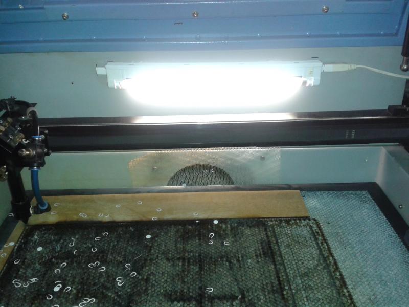

                            Here is our laser with a cheap fluorescent light
                            The mesh at the exhaust outlet saves us cleaning the blower every month now it is only every 6 months. The blower is 2 metres above ground outside.
