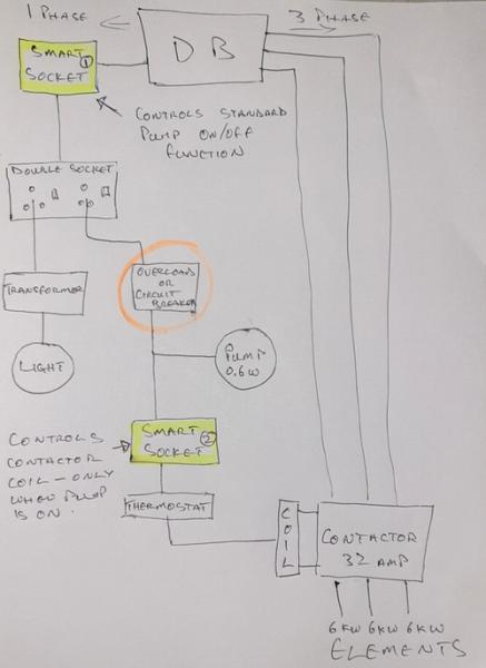

        @AndyD
        If I want to make sure that no power gets to the elements in the event of the pool pump failing or straining due to a blocked inlet of filter, could I use a circuit breaker installed in the feed to the motor. Sorry, I am probably using all the wrong terminology here. If so, what amp rating should it be that it trips fairly easily - the pump is a 0.6 kw single phase.
        I tried to sketch my wiring plan below.
          • 1488
          I would install a " water flow switch" in the water line with a normal open contact - Fit the contact between the thermostat and coil in your wiring drawing.
          When the pump comes on the water will flow and the switch will close allowing the heater contact to close
          You get cheap ones that work fine with a pool pump - you don't need a high tech one costing in excess of 1K
