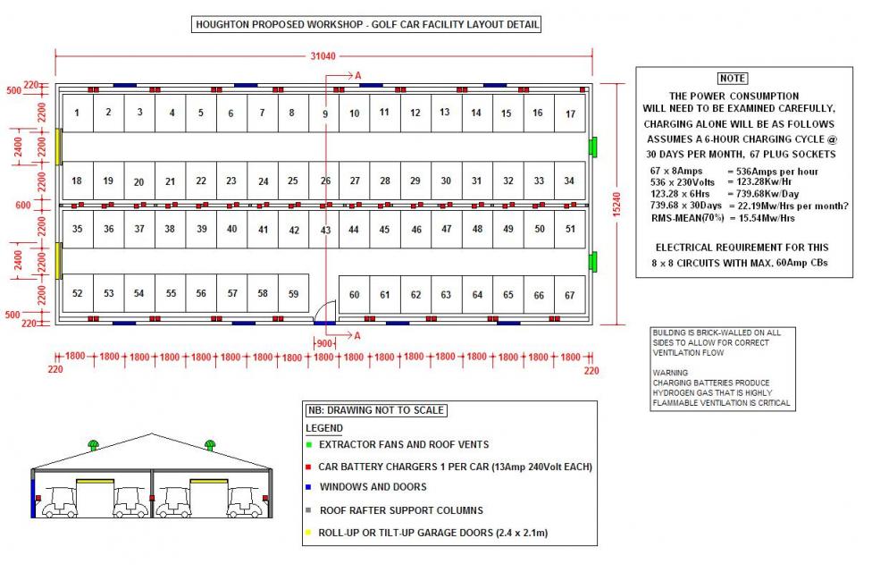

            Wind Power RMS
            When you want to calculate the output power of a device, such as the wind-power generator you need to consider a few other facts.
            The output power of the unit is, say, 1000W (this is probably max output), use the RMS value (70%) to determine the constant power out, 1000/70% = 700W.
            Understanding electrical principles is difficult if you don't have the manual but here's an example of a computation I had to do for a Golf Car charging facility.
