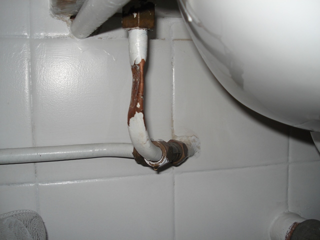

      hers a pic of my first attempt to flatten the copper pipe to try stop the water...and you wonder why this fool was stressing so much...firstly my daughter was coughing and getting sick from the injections she had today and the basin fills faster than it drains...and we have wooden floors.

        my attempt to shut off the water by squashing the pipe...unsuccessful

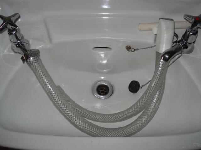

          fianlly around 3 this morning i managed to slow it down...found a piece of pipe in my garage....a hose pipe clamp and some tape.

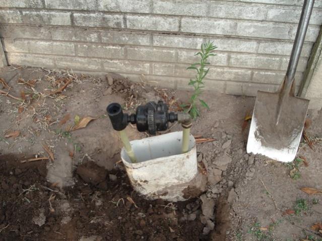

            as you can see from this picture taken this morning after i closed the holes...i had been digging around the meter at 1.30 am hoping to find a tap buried in the ground with no success...
            a tip for anyone who experieces this problem and gets into the sh*t like i did...
            at the top left hand side of the meter there is a yellow cap with an off round shape...you take a bolt which uses a 17 sapnner fits in that shape then you loosen the top off...then take a 10 allen key and push it into the hole which fits the allen key then tighten it...this is how the council switch off your water.
