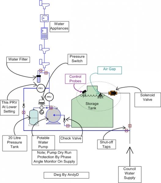

    I'm trying to keep this simple and I'll draw you a schematic and post it when I have aminute.
      Okay here's a drawing. It's not comprehensive, I didn't have time to show any dry run protection for the pump but this can be a phase angle monitor on the supply which is saimpler to install than long low level probes in the tank.
      If I've misunderstood your layout just shout, I can ammend the dwg if need be.

        Andy, thank you very much. I will go study the drawing and come back.
          No probs. I ammended the dwg with some more info and added a few shut-off valves (ball valves/taps). Also you can substitute the probe set and solenoid valve at the tank for a good old fashioned ball-cock system if you like, it's simpler and less to go wrong.

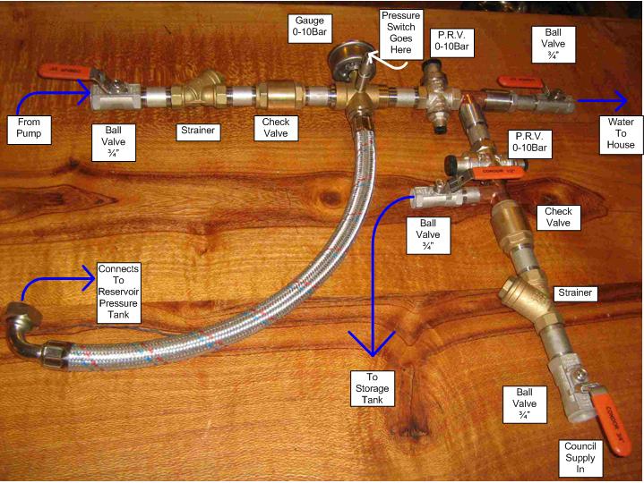

                Wow, your system is very spread out, I can see there's been quite some evolution to where you are now.
                When we install this kinda system in commercial and industrial applications we basically fit all the components together in a solid manifold with stainless steel or galvanised threaded fittings, mount it somewhere solid like on a back-plate then bring all the various pipes into it. This makes for easier maintenance or fault-finding in future.
                Originally posted by IMHO
                Andy, what would be the easiest and least expensive way to make this setup better. I agree with what you suggest, but I am looking for an easy way out, without replacing everything I got.
                I'm sure you can re-use most of your existing components. Just lose all those HDPE fittings and get some threaded fittings to make a manifold. You can use any amount of artistic license when it comes to the size or shape as long as it's topographically correct. This one I dry assembled from bits in my workshop so ignore the copper tee's, I didn't have any s/steel ones in stock

                  @Andy
                  I've been following this thread with extreme interest for a number of reasons.
                  Without wanting to hijack the thread, could I ask you to please explain a few things for me (looking at your pdf drawing):
                  1. what is the purpose of the (blue) bypass line from the Council Supply to the 'Lower setting' PRV ?
                  2. I don't see any output from the Pressure Tank, so don't understand why it's there. Surely it should have some in/out flow ? Or is it used to simply store pressure. If so, wouldn't the pipes going to the building contain the same pressure ?
                  3. is the PRV ( just above the pump ) there to control the pressure supplied to the building, irrespective of the pressure delivered by the pump ?
                  4. I assume the dotted line from the pressure switch is there to indicate that the drop in pressure at the switch ( caused by opening a tap in the building ) would cause the pressure switch to register a drop in pressure, and would send an (electronic ?) signal to the pump to activate ?
                    Hi Dave, that pipe is the 'back-up' water supply in case of power cuts/pump failure. The PRV is set lower to make it redundant if the system is at pump pressure. I included it in the drawing because IMHO stated in his OP;
                    The municipal supply link to this supply from the tank, so that when the pump is out of action for some reason, we still have minimal water pressure in the house.
                    Thinking again about it that PRV could in fact be set marginally higher than the PRV on the pump output. This would then mean as long as the council pressure is equal to or higher than the PRV setting then the pump won't run. If or when the council pressure drops below the setting of the pressure switch then the pump will take over supplying the house. This might be a better set up, it would make the life of the pump longer.
                    There is a single hose to the pressure tank, water flows into and out of the tank via the same hose. The tank has an internal rubber bladder which is pumped up to around 1 Bar with air. When the pump runs it charges the tank and the bladder compresses. When the pump is off and water is being used at the house the pressure tank will supply this water until the bladder expands again to a point where the pressure drops sufficiently for the pump to restart. It just provide a buffer reservoir of water under pressure to prevent the pump rapid cycling.
                    Yes, the PRV would supply the house with a constant pressure regardless of the pump output pressure being higher.
                    The drawing wasn't the greatest, it was a bit of a rush job. The dotted line was just to associate the pressure switch with the pump it's controlling. The pressure switch is mechanical, it has a set of electrical contacts that make when the pressure drops below a preset point which starts the pump. The contacts then break when the pressure rises above a preset point which stops the pump.
