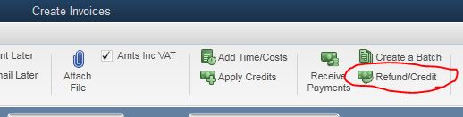

                Originally posted by AmithS
                1. What happens if the invoice is already affected by a VAT invoice? How do you then cancel the transaction
                If you have processed a VAT return that includes the invoice in question, you definitely must not void the invoice. You would need to process a credit note reversing the invoice (in my version of Quickbooks this is a click-one-button deal if you have the invoice you want to credit open).
                I have to say, I was a bit reluctant to raise the editing functionality within Quickbooks at all for a couple of reasons:
                1. It is viewed with suspicion by many in the accounting fraternity within South Africa
                2. It does take a bit of thought as to when it is appropriate to use it.
                Quickbooks is pretty good at warning you when you're going to do something inadvisable though.
                And used correctly, editing an entry rather than posting correcting entries certainly helps keep the books tidy and easier to follow.

                    Thanks Dave, I see I have the option in your picture available. So if I understand this correctly this method would then adjust the VAT in the current VAT period to recover the VAT paid in the previous VAT period?
                        Mind you (just to be clear), if you have already filed the VAT return on the transaction you're reversing, it is my habit not to introduce new entries into the closed period. I rather post the reversing entry dated after the closing date.
