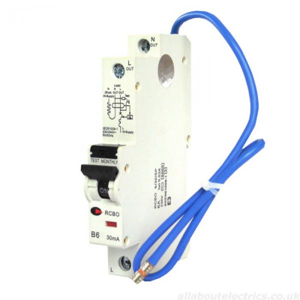

                        It's getting more and more common nowadays where the global cumulative leakage in a house exceeds the 20-30mA tripping threshold. Computers have an acceptable leakage of 1-3mA because of their built-in surge arrestors, same with many switch-mode power supplies like laptops, phone and battery chargers etc. Many people don't understand that the earth on majority of circuits is functional and not only there to prevent shocks through elevated touch voltages. Having a standing leakage of 10-15 mA isn't unusual and it doesn't leave much room for very minor fault currents that wouldn't otherwise be a problem.
                        Often the only solution is to spread the load through more than one RCD (earth leakage). Pretty soon each circuit should have its own RCBO which is a much better system than just one or two RCD's.
                        RCBO's are still coming down in size and in price but it would be good practice to install them on the socket circuits if you can fit them in the DB.
