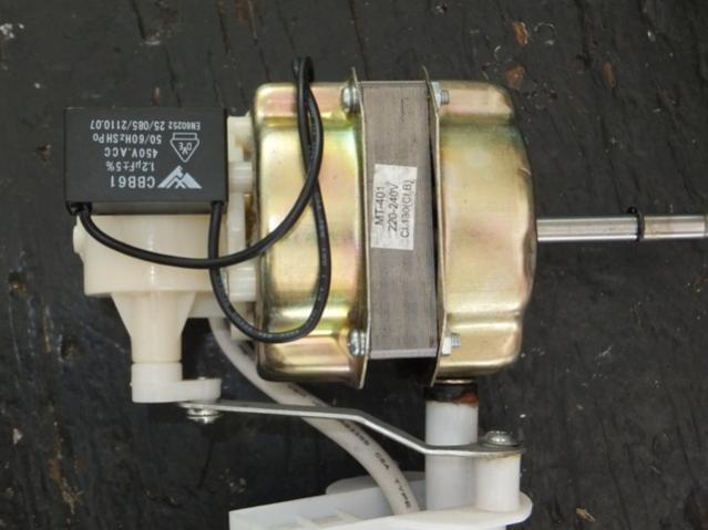

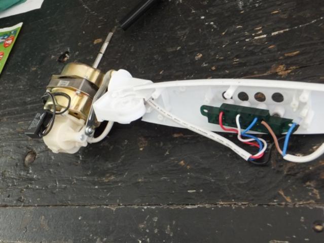

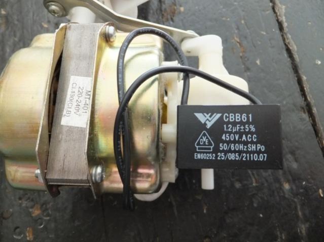

                        Hi AndyD here are some images of the motor and switch Click image for larger version

                          That looks like a standard motor with three speed windings. If it's not running at all and there's nothing showing on a clamp meter if power is applied then either the windings are damaged and open circuit or there may be a non-resettable thermal fuse laced onto the windings for overheating protection. To find out you'll need to dismantle the motor. Winding damage should be visable and you'll usually smell it as well and you can test if this fuse or thermistor has blown by bypassing it. Replacements are available from RS Components or ACDC. Sometimes these thermal fuses are easily accessible but sometimes you've got to do some surgery on the windings to expose them.
                          If the fuse has no markings on it then I'd suggest the replacement should be around 120 degrees C, these small motors often run quite hot so I wouldn't go below 100C and with standard winding shellac I wouldn't go above 130C.
                          The most likely cause of the thermal fuse blowing would be stiff rotor bearings/bushes, dust filled vents at the rear of the plastic motor housing or maybe people hanging clothes or towels over the fan which restricted airflow through the motor or were too heavy for the fan to oscilate side to side.

                            Thanks AndyD there is no burnt insulation smell and the rotor spins freely I shall preform surgery ( I like that ) on the motor only problem is 9 times out of 10, once surgery has been preformed on motors of this size they tend to end up slightly distorted i.e.they are never the same again,although if I get it to work there will be one happier pensioner what with the weather we are having in Cape Town at the moment.
                              Yeah, it's a bit of an unknown until you crack one open. You might be lucky and it's immediately visible but sometimes they bury it quite deep in the windings and varnish over it then truss it up like a Christmas turkey with straps and string.
                              If you've got 3 identical fans then I'd go in with a veiw to sacrificing one as school fees for the greater good of the remaining two. Sometimes the thermal fuse looks a bit like a small capicitor type thing with a roundish body and the two legs exiting on the same side and sometimes it's a device that is the same form factor as a standard resistor or diode with a longer shape and one leg exiting each end.
                              I can only wish you luck
