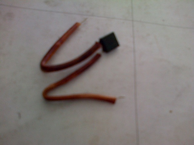

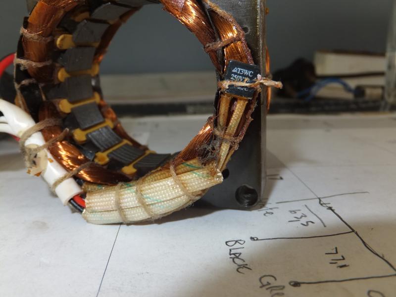

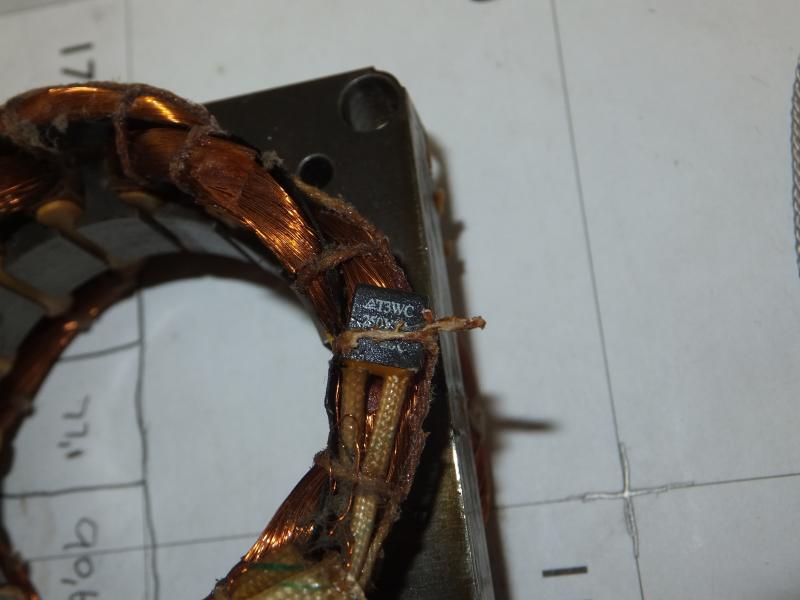

Hi Andy found the non-resettable thermal fuse after dissecting the motor managed to get one going thanks for the info you are a mine of information, although to day it is so much easier to obtain information from the internet, I remember when I was doing my apprenticeship I asked my journeyman a question about the differences between an electrolytic and a dielectric capacitor, he promptly told me to go to the library and look it up because if he told me I would forget he was right but enough of my rambling
