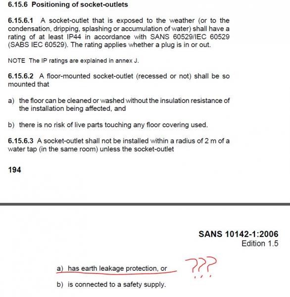

    [Question] Socket Outlet positionings
    When I was reading through my SANS 10142 book, I came across a statement which I think does not make sense to me, see bow pic
    Does this means you can install the SSO even in water??
Name:	SSO Positioning.jpg

    You may, provided it complies with the conditions stipulated. Why would you?

          Hi Slow Blow, I beg to differ. Over the bath would be zone 1 up to 2.5m high from the water so no plugs allowed, zone 2 within 600mm from the bath edge also no plug unless 50va safety supply like a shaver. Zone 3 outside 600mm would be the closest you can mount a plug to a bath or shower.
          So to answer the initial question, no you can't mount a socket outlet in water, first check the zone rules for baths, showers, pools, fountains etc.
            "Does this means you can install the SSO even in water??"
            6.15.6.2 answers your question...The insulation resistance must not be affected. So you might say but I can seal the box, you would be correct, but you would never be able to use the socket outlet.

              Hi Ians, 6.15.6.2 pertains specifically to a recessed floor plug and has nothing to do with mounting a plug in or near water.
              The same can't be said for other parts of sans 10142 but when it comes to socket outlets and water then it is very clear as to what you are allowed or not allowed to do.
                  [ATTACH=CONFIG]4421[/ATTACH]
                  I was responding to this question with this attachment. Common sense would tell me that the insulation resistance of "any socket outlet" regardless of its location, bathroom, kitchen, outdoors, etc, would be affected if installed "in water".
                  This question makes me think of the picture doing the rounds, where there is a multi plug floating on a slop in a pool. Nothing illegal about it, because for one it doesn't form part of the electrical installation as it is cable plugged into a socket outlet. There would be people stupid enough to actually do it. So long as the electrician who installed and connected the socket outlet which is fed from is done according to regulations, there would be no recourse on him.
                  However in saying that, I have seen on more than one occasion on work sites where it is pouring down with rain and plugs are exposed in puddles, which is just as risky.
                  This is why there have to be at least a basic set of rules.

                    I think what is forgotten at times when it comes to complying with the standard, is that you have to comply with the whole standard.
                    The question one has to ask is not - "does this comply with this part of the standard", but "does it transgress any part of the standard?"
                    In relation to socket outlets and water, it's highly likely that parts of section 7 Special installations or locations will also be applicable, not just S 16.6.
