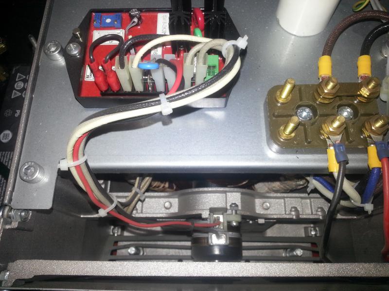

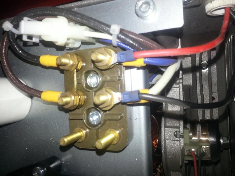

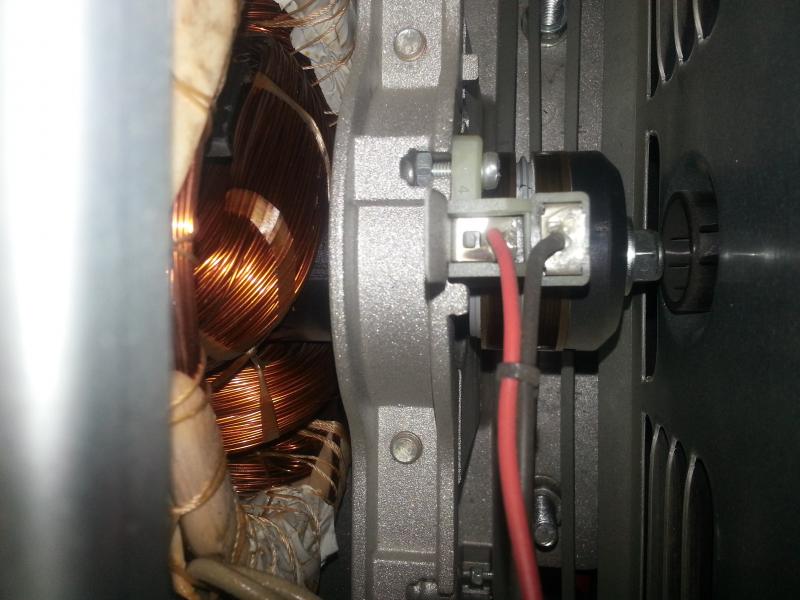

    The problem with a lot of the small generators is the the neutral is at an equal voltage as the live with respect to earth so they're configured 115(L)-0(Earth)-115(Neutral) L-N is 230v. You cannot connect this type of genny to a DB, it's designed for use with trailing leads only. Also genny's are notoriously poor at producing sufficient current in the case of a fault and don't achieve required disconnection times of circuit breakers or other OCPD's.
Name:	honda 15kva connection 1.jpg
ID:	264378Click image for larger version
Name:	honda 15kva windings.jpg
ID:	264379Click image for larger version
Name:	honda 15kva exciter.jpg
    Hi Andy will this honda 15kva sp gennie be one of those? (my generator internal workings is limited )
    anyway i cannot see this setup with that (2.5mm?) red and black to that plug sustaining a 50-60 Amp load for long but who am i to say that is after all a honda generator with a sabs mark?

      Eek, 'plugging it in' would not be a wise move.
      In some smaller site type generators the centre of the windings is actually tapped and bonded to the chassis as an earth which ties both L and N at 110v wrt earth, they're not floating. The problem is when the centre tapped earth is bonded internally to the generator chassis. If you bridge a centre tapped earth and neutral you're effectively shorting out half of the winding which would cause a fault condition and probably damage to the windings. This is what would happen with a cowboy connection into a DB.
      These generators are designed to be used with extension leads only.
