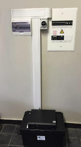

        Just completed an installation. Pulling my hair out. Earth leakage keeps tripping when running on inverter
        mode. Apparently their are different types of earth leakage units.
        Type AC, sensitive to alternating current only
        Type A, sensitive to alternating current and/or pulsating current with DC components.
        Don't know if you have also experienced this.

          Nice job!
          Like the trunking you used and the way it has the curve into the flush mounted DB, very neat.
          I had no idea there was AC & A type earth leakages. Would the A type earth leakage have a difference with tripping on the inverter?
          Normally we just implement a connection box at the output of the inverter/generator with a neutral bar inside and do a earth neutral connection and label it on the box.
          This is also the point where we bring our earth spike into the installation, so kind off kills 2 birds with one stone + being able to safely earth the alternative supply.

            Hi Dieter,
            Thanks for the compliment. The trunking is quite expensive but comes with all types of accesories,
            making a neat job. I was also not aware of different types of earth leakage units.
            Type AC should be fine on Pure sine wave inverters and Type A should work on Modified sine wave inverters. I will be doing further tests and let you know the outcome

              It wasn't neccesary to use a Type A Earth leakage unit. Found that the type Ac I was using was faulty.
              Installed a new one and problem solved.
