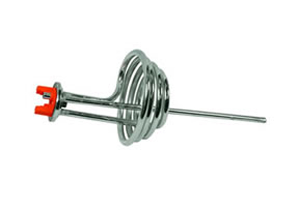

                      Many geyser elements don't actually have any wiring as such, the thermostat is wired and it pushes into the element with spade terminals basically like a plug and socket. Are you saying a plumber shouldn't be able to pull out the thermostat to allow the element to be replaced?
Name:	okay element.jpg

                        In regards to your push in spade elements, if that is the case and no electrical connection are disconnected and reconnected then I do not forsee any problems in regards to that. If you would like to put your worries at rest then I can supply you with the AIA for Gauteng's number and you can give him a call to get clarity on what you are allowed to do as a plumber and what not.

                          Andy, in most cases the wires connected to the element are short and do not allow for the complete withdrawal of the thermostat without being disconnected from the thermostat. There are also other types which are not push in which require a while different approach. Then there is also the question of the cover which in many cases never gets replaced by the plumber leaving the wires exposed.
