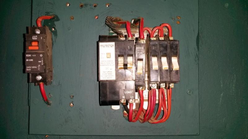

          Leecatt. Thanx for mentioning that. The small little town I stay in currently have lots of old houses with open wiring and they use the steel conduit as earth. Most of the plugs you can see are changed during the course of time even the light switches are changed from the old round switches mounted on the wooden blocks to new steel wall boxes and switches. The DB's are quite a shock to see sometimes where the wires are open, stove and geyser on one circuit, mcb's are not labelled, the list go on. Now, my recommendation usually to the owner is to either replace the steel wall boxes, plugs and light switches with PVC type, or draw in an earth wire to earth the steel boxes, as according to reg. "6.12.1.3 a wireway shall not be used as an earth continuity conductor". However I must say, some of the installations are still in quite good condition and some of the additions were done good, but then you get the additions where I think for myself where on earth did this guy get his/her training and where is the pride in their work. Just one of the many crazy stuff I cameaccross. Click image for larger version
