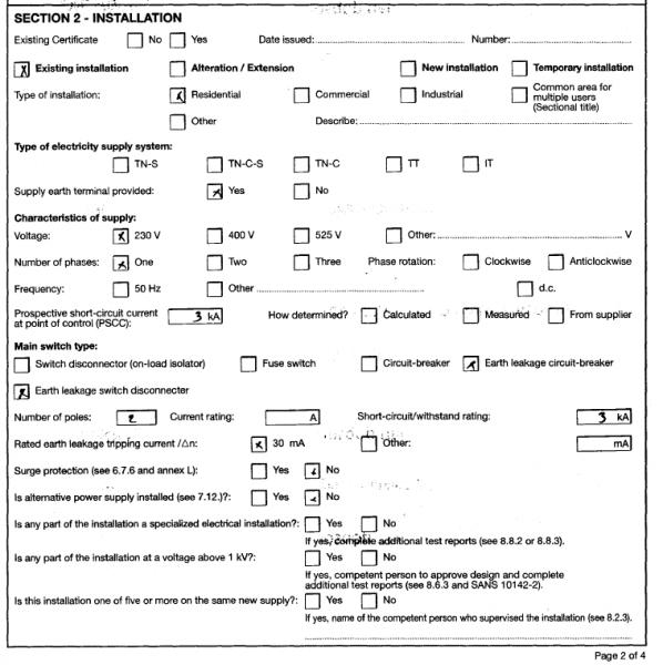

              What earthing arrangement was the installation stated as having on the CoC?
              No explicit earthing arrangement was even marked on the CoC, See screenshot 1 for reference.

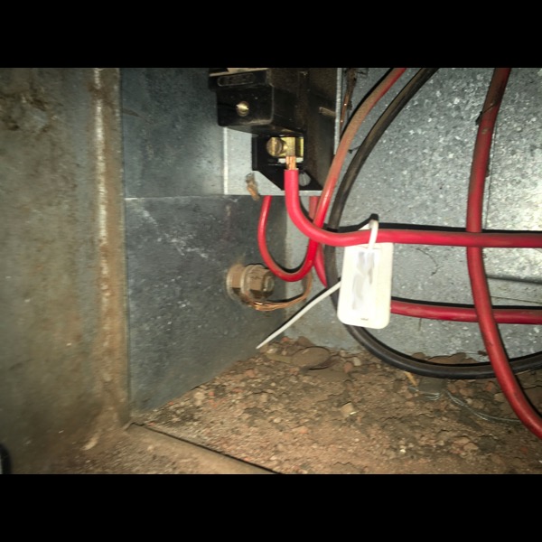

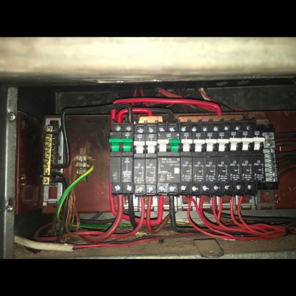

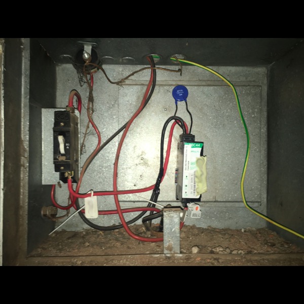

              Some pics of my DB board, if this helps?

                • 22820
                Originally posted by grootoog
                I still have no idea how it could go "lost" surely earthing is a permanently fixed cable which needs to go to the DB board?
                ... and all the way back to the neutral point of the mains supply transformer. The causes normally are cable theft, cable damage, tampering and/or corrosion (in no particular order).
                On that COC section 2 you've posted - it's incomplete (and that's putting it mildly).
                I'm also highly suspicious of the PSCC reading supplied. Either the issuer doesn't know what they're doing or they don't have the correct equipment to carry out the test. (Or both).
                  That CoC in the screenshot is appalling, at a glance there's at least 8 omissions on that page. Whoever issued it was half hearted to say the least so I'd also take any info given with a large pinch of salt.
                  I'm also a bit confused looking at the third photo, it looks like it might be a TN S supply that's simply not got the earth connected but it's a bit difficult to tell from the photo. Also not sure what that blue MOV looking device is there for either, I hope that's not someone's idea of lightning protection......

                    The COC is unacceptable. I would assume that the PSCC is the fault rating that has been taken from the switchgear rather than a calculated or measured reading of the installation. The main switch is a disconnector and not earth leakage disconnector as stated on the COC. It would also appear that the incoming mains is connected to the load side of the isolator. I am not sure whether CBI allows this on their switchgear but if they do I assume there is no labelling to this effect on the DB.

                      When I saw what was filled out on the COC my first thought was that there was never a loop impedance test carried out, my reasoning being that normally the PSC and loop impedance tests are done with the same meter and if the PSC was thumb sucked, the same happened with the loop impedance.
                      There looks to be an old Heinemann outdoor surge arrestor in the top left of the meter board, and by the looks of the pictures, as far as I can see is there is no earth from the supplier.
                      I know that JHB city does not supply an earth, and I am assuming this is installation is in Germiston from the location of the OP, so maybe they did the same as JHB and used the old galvanized water pipes as an earth many years ago and the pipes have since been changed to plastic and so the earth was lost and nobody ever bothered to check it.
