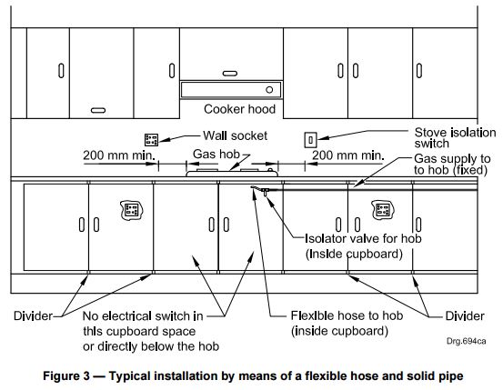

    Here are the relevant diagrams:
    Typical installation by means of a flexible hose and solid pipe -
Name:	installation with flexible hose and solid pipe.JPG

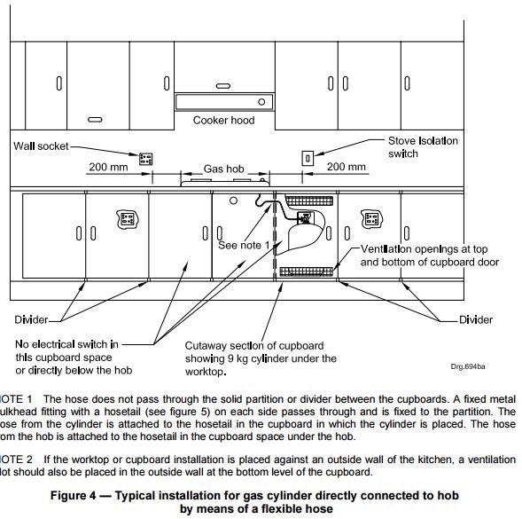

    Typical installation for gas cylinder directly connected to hob by means of a flexible hose -
Name:	installation with flexible hose and gas cylinder.JPG
                    Hmmm, Dave your statement might be misleading to the uninformed. A gas cylinder may not be directly connected to a hob with a flexible hose if it passes through a compartment divider. As per Figure 4, Note 1, you need a fixed (metal) bulkhead connector installed in the divider with a flexible hose connected on either side. In reality you need to do this: Gas cylinder > hose > bulkhead connector 1 > divider > bulkhead connector 2 > flexible house > hob. I prefer to see the use of a short length of gas certified copper pipe and brass barbed compression nipples instead of the two bulkhead connectors.
                    On your question as to gas hob + electric stove please read Section 9 and I quote:
                    "9 Electrical equipment and other sources of ignition
                    Where electrical equipment is placed within the safety distance as specified in figures 3, 4 and 6
                    such equipment shall be in accordance with the requirements of SANS 10108.
                    Electrical equipment, such as light switches and plugs, shall be at least 200 mm away from any
                    burner and potential point of gas release. Where it is necessary to install a gas hob together with an
                    electric oven, a three-point plug socket shall not be used to connect the electric oven. A proper
                    isolator switch shall be in place above the level of the hob and it shall have at least 200 mm
                    clearance from the hob.
                    No electrical connection shall be made below the hob. See figures 3 and 4 for further connections."
                    My understanding of the above is the word switch means any isolator, plug or light switch and as long as these are not present you may install an electrical stove below the hob. Personally I would like to see the stove opening permanently ventilated to ensure any possible gas leaks run straight onto the floor and then hopefully to the required ventilation opening at floor level (if ever installed or the 6mm gap below the door frame created).
