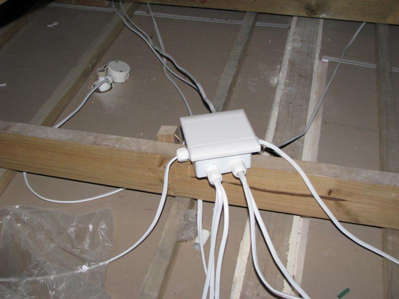

Compliance of electrical wiring in ceiling space
The only thing I can see that's not compliant is the proximity of the conduit box to the lamp in the downlight but if it's LED even that isn't an issue. Maybe lack of strain relief for the connection in the conduit box but as already stated whilst it's an untidy installation it's not illegal._______________________________________________
If there is a gland on the underside of the conduit box that provides adequate strain relief for the connections within the conduit box then I would say its compliant.
If there is no gland however I would fail it.
Something else is that there is more than one cable in some of the glands. I read a long time ago in the regs, and now I cannot find it, that each piece of equipment must be utilised as It was originally intended. I am sure that this means there should only be one cable per glandTo make a mistake is human, to learn from that mistake is knowledge and knowledge is strength.Comment
.....Something else is that there is more than one cable in some of the glands. I read a long time ago in the regs, and now I cannot find it, that each piece of equipment must be utilised as It was originally intended. I am sure that this means there should only be one cable per gland
I see where you're coming from but I'm not usually quite that pedantic to be honest, if there's a gland or an alternative entry system and it's maintaining the IP level and providing reasonable strain relief I wouldn't fail it._______________________________________________

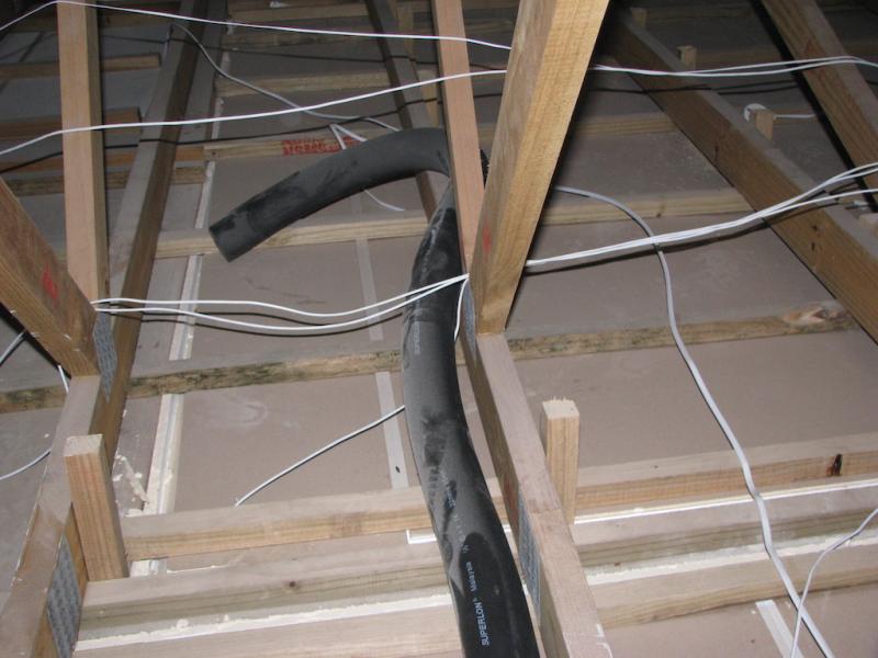

The only thing wrong in the pic, the twin and earth is running on top on the beams. The twin+e is not protected on the beams, any person working in the roof space could damage the wire and expose the live conductors. I am sure you could find a clause in the SANS if you really looked and interpreted it a way to point this out. What you would then do with the info is the part that makes me laugh at this industry. It is like trying to tell a taxi boss his body guards are not allowed to carry full automatic weapons like and AK 47. I dare you to waste the time and energy.Comments are based on opinion...not always facts....that's why people use an alias.Comment
Its not illegal for wires but the only things that was supposed to be done interms of safety wire and neat.To put a Pvc conduit pipes n Junction boxes for connectionComment
if you take a close look...you will note the 230 volts lamp holder has no earth terminal to to earth the frame of the down light.
you will also note that some of the twin +e runs under the beam...why they didnt install all the twin +e under the beams only the almighty above could explain.

a simple thing like a walk way (made up of board or battens) in the middle of a ceiling space (below the highest points)...should be law for people building houses...with a space left on either side for wiring and plumbing...which cannot be damaged by workers safety boots.
no wiring should be allowed below the centre (highest point in the ceiling space) unless suitably mechanically protected.

I HAVE BEEN PUTTING 2 WIRES IN 1 GLAND FOR YEARS SO IS MY INSTALLATION WRONG ,NEVER NEW THAT AFTER 32 YEARS WHERE DOES IT MAKE THE INSTALLATION UNSAFEComment
Hi there, I think what we really need to see (in this pic) is the inside of that box.......and some test results.....Comment
