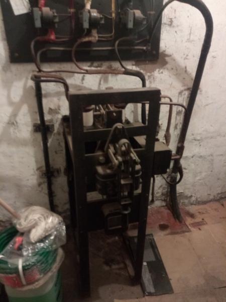

    Check this "Main Switch"
    This is what we found at the mains position as the 'main switch'
    Not sure if that is SABS approved....
    That's a thing of beauty. Bet it still works as well as the day it was installed. Where did you come across that?
    • SilverNodashi
      • May 2007
      • 1197
      That's ancient, and it still works. Nice !
      • skatingsparks
        • Mar 2008
        • 376
        In Killarney, Johannesburg. We were asked to do a domestic (I really don't liker domestics).
        I checked some of the other flats, they still have rewirable fuses, no earth leakage (on anything). That nice cloth cable (as I call it) in the conduits for the risers and pretty much everywhere else.
        Those bus bars are just covered in (old flaky) tape
          There could be asbestos components such as flash guards so I wouldn't disturd anything unless absolutely necessary.
