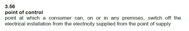

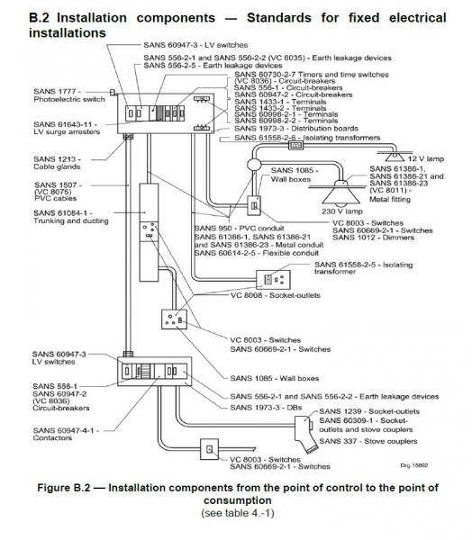

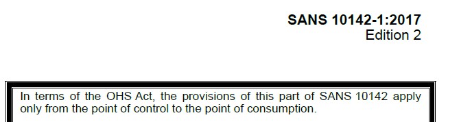

            I respectfully disagree. PV Panels and its wiring is not a point of control as defined in the regs. Therefor it is not part of an electrical installation as defined.

              • 1473
              Hi
              Not sure I fully understand your reasoning behind your above statement .
              Sans 10142-1 applies from point of control on wards - We both agree
              Point of control - point at which a consumer can switch off the electrical installation from the electricity supplied from the point of supply - We both agree but you need to include the definition, point of supply
              Point of supply - point at which a supplier supplies electricity to any premises
              If we take all domestic installations and the majority of commercial installations , the PV panels/inverter will be connected after the point of control and would therefore be part of the electrical installation.
              There are installations where the PV panel / inverter will be connected before the point of supply/control and then I suppose technically the area becomes grey as no COC needs to be issued.But these are big installations where arrangements are made with the municipalities and Eskom under separate agreements of which I do not know too much about.
              SANS 10142-1 has a complete section 7.12 Alternative Supplies( pg 244 to 250) and specifically mentions PV installations and deals with issues around PV installations - 7.12.7.2 states the DC component of PV systems shall comply to 7.15 , DC Installations ( pg 256)
              I don't see how the statement can be made that PV is not part of an electrical installation and would not form part of the COC when SANS 10142-1 incorporates PV within the regulations.
              Am I missing something ?

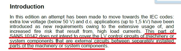

                    can you switch off or control the pv panels at the "point of Control" in any way, If yes, then I agree. If no, then it falls outside this definition and cannot be "certified" by a CoC.

                    "Point of control - point at which a consumer can switch off the electrical installation from the electricity supplied from the point of supply - We both agree but you need to include the definition, point of supply"
                    You decided that, that must be included in the definition, but it is not as it is written in the regs?

                        I am still confused why an INSTALLATION is defined from the point of control to the point of consumption. It should then read from the point of supply.
                        I will write the Chief Inspector to clear that up for me. His answer will give closure. The definition of "Installation" should then be from the point of supply to the point of consumption.

                        7.16.1 General
                        The distribution system is that part of the installation between the point of
                        control connected to the point of supply where electricity is supplied by the
                        supply authority,
                        and the point of control of any particular electrical
                        installation connected thereto, whether it is a specific user or a communal
                        installation, where the user of that particular installation can switch it off.
                        3.56
                        point of control
                        point at which a consumer can, on or in any premises, switch off the
