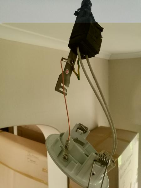

    • ELECT 1
      • Dec 2013
      • 78
      So this is how it looks
      also did one with green earth wire
        • 4927
        ^^ Yeah, that's the type I've seen before, but with the 12 volt downlight rings there's usually no earth screw provided for a flylead because the 12v transformers are classII insulated making an earth optional. I personally would avoid converting or retrofitting old 12v downlights into 230v GU10 especially given the very low cost of a complete new GU10 fitting.

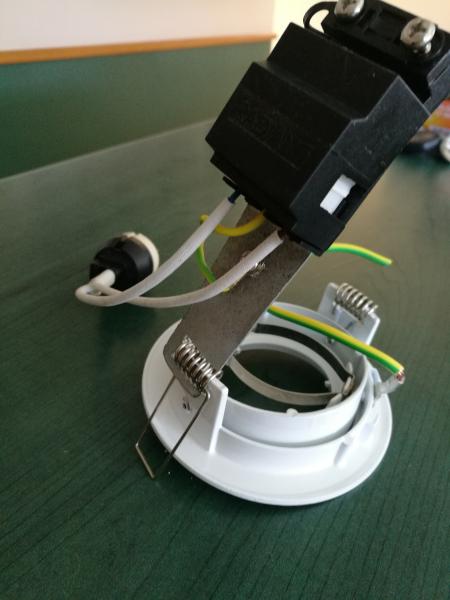

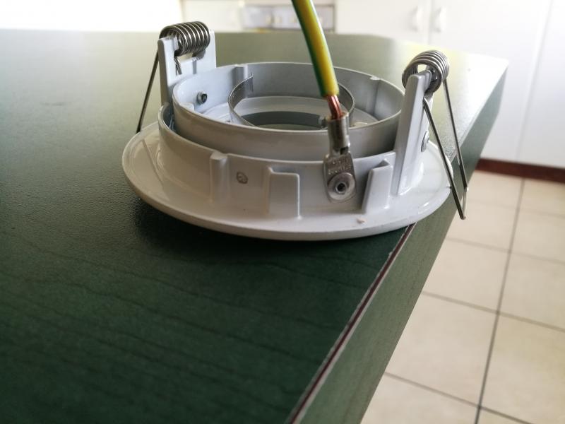

            • ELECT 1
              • Dec 2013
              • 78
              The other peculiar reg is no exposed wiring......hehee but coming from the lamp holder there are two exposed wires going into the GU lamp holder (220v)
              There are just some cases that you cant help having an exposed wire, but is it safe, thats will be the opinion of the installer at the time.
              Which brings in another question, was the installer at the time making a reasonable judgement. You see where i am going....hehheee
              • ELECT 1
                • Dec 2013
                • 78
                So the one picture is what the earthing was supposed to look like...sort of make shift i would say, and the paint would have to be scraped.
                The other pic is using the same fittings but pop rivet an earth wire. The rivet has to be minute so as not to interfere with
                the tilt process.
                I think that the regs for this stuff should be revisited as its starting to get crazy.....1000 fittings can be tough to redo.
