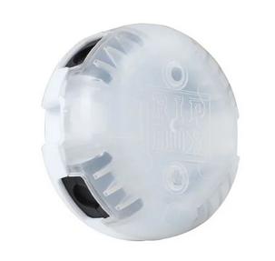

            What is your opinion on cutting off the chocolate box enclosure that's supplied with those lights and using a Ripbox to join the light wires to the TFE inside the box? Enough ports to accommodate the loops.

            • Dylboy
              • Jun 2020
              • 777
              Seen and thought of that box too
              Initially I did not see a SANS stamp but not sure if that stuff is even required anymore ????
              Anyway I would like to try it
              Edit: also not sure if that box can fit through the standard dowlight cutout.

              • Andrew_van_Zyl
                • Mar 2022
                • 131
                I haven't had a problem yet. I downloaded this info - it's got the specs and certifications. Just expensive but what isn't nowdaysRIPBOX_V1.pdf
