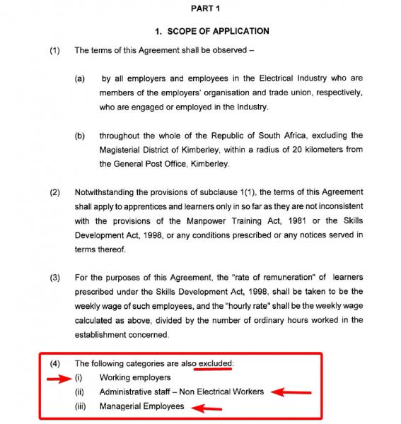

                          #27
                          I agree with the regs you have posted.
                          Clearly the article mislead one to believe that YOU MUST REGISTER WITH NBCEI - FALSE.
                          It also states that only a IE or MIE can qualify and register to be an electrical contractor at DOL -FALSE. SPT can also qualify and register.
                          Also it mentioned that the point of control and the point of consumption, WHICH DEFINES AN INSTALLATION, has been removed. Again, FASLE. A LIE.
                          It is still there.
                          By your own post:
                          3.33
                          electrical installation
                          machinery, in or on any premises, that is used for the transmission of electrical
                          energy from a point of control (see 3.56) to a point of consumption
                          (see 3.55) anywhere on the premises, including any article that forms part of
                          such an installation, irrespective of whether or not it is part of the electrical
                          circuit, but excluding
                          a) any machinery of the supplier that is related to the supply of electricity on
                          the premises,
                          b) any machinery that is used for the transmission of electricity of which the
                          voltage does not exceed 50 V, where such electricity is not derived from
                          the main supply of a supplier, and
                          c) any machinery that transmits electrical energy in telecommunication,
                          television or radio circuits..........
                          Anyway, thanks for the points made i truly appreciate it. Have a good weekend.

                            • 1483
                            #28
                            It is impossible to do a PV installation by yourself so you will definitely have a helper - If you have a helper he needs to be registered with NBCEI
                            Yes a SPT ca n register as an electrical contractor but as a SPT registered contractor you cannot sign off on DC work as per Annex M
                            It is still there.
                            The doubt has been removed by the definition 3.16 - If the consumer installed and users the electricity then it is part of the electrical installation . The definition for Point of supply ( 3.58) and Supplier ( 3.77) has been updated and a consumers own PV plant is not a point of supply - Only a person that has contracted to supply electricity to another person is a supplier , like a shopping center owner. If the shopping center owner installs PV then he uses it for himself and is a consumer not a supplier. So the shopping center owner is both a supplier and consumer.
                            The detail is in the definitions before reading the clauses
                            The PV is in-between the point of supply and point of consumption and therefore part of the electrical installation
