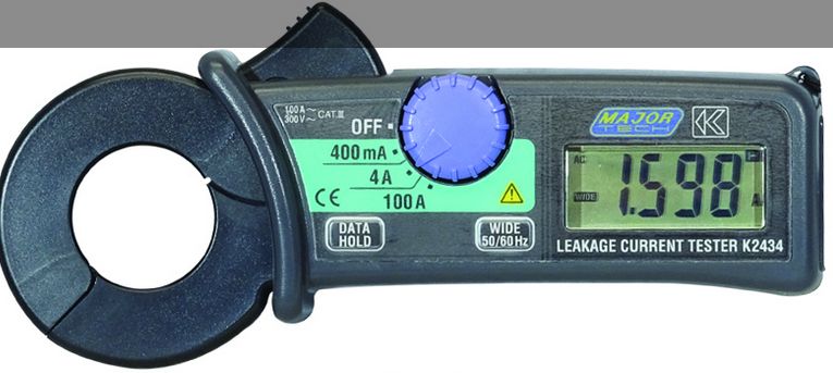

        I have a Majortech 2434 Tester that works well for tracing earth leakage currents down to 0.1 mA. I recalled it didn't cost that much at the time (got it for my peeps when Andy did his wonderful thread on tracking down earth leakage faults). But looking at the list price of it now as just under R7k?
        Check around for pricing, I guess. But a nice unit.

          That major tech one is awesome but ya that price is massive for me hahaha.

                          I also sometimes use a Kyoritsu K2434 that Dave highlighted. Great tester, I've always liked Kyoritsu but quite pricey nowadays I see.

                            I have seen that brand and was not sure of it's quality but glad to hear some feedback and that it is pretty decent
