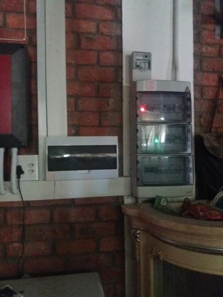

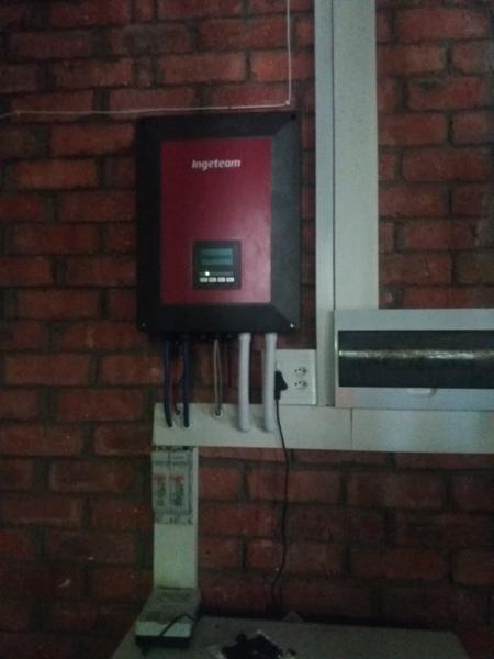

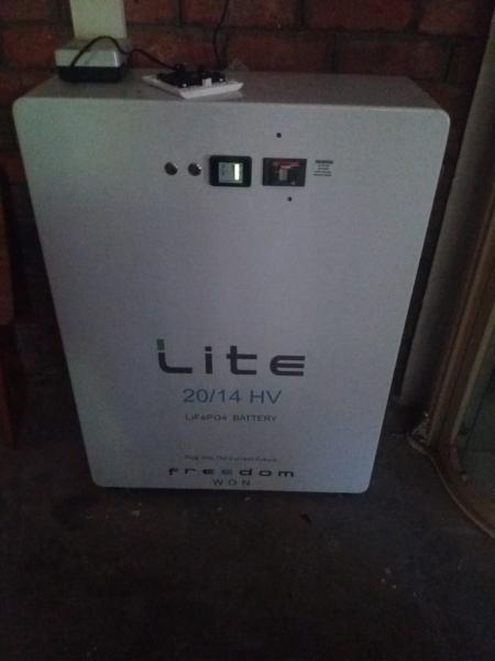

      Had to give a pass on a COC inspection today.
      New PV system installed by one of the bigger local installers.
      Seems like quite a kiff setup.
      No COC supplied.
      The fight started when the client phoned the installer inquiring about a COC.
      I courteously greeted him and left.
