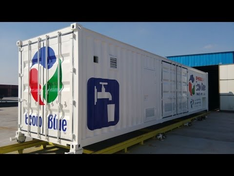

    The second video seems to be a complete unit, however what is not discussed is the amount of energy required to get the water from the air, and the actual cost of the unit.
    Effectively this is a refrigeration system, which cools the air to cause the water in the air to condensate. The more humid the air the more effective the system is.
