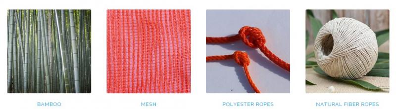

              I would like to construct one myself. It looks simple enough and actually will look good in the garden. here is more information.
              Warka WaterTowers Design
              Included is a list of materials used.
              [ATTACH=CONFIG]6123[/ATTACH]
              It looks easy enough to build, but I wonder if a smaller version will work?
                It will definitely work, the amount of daily water yield may be little. Surface area of the mesh and cooling stage are directly proportional to the amount of precipitated water collected.
                It will be a good experiment for you to actually experience the daily yield of water collected across the seasons. From the data collected, it can be deduced if the project will work under large scale construction.
