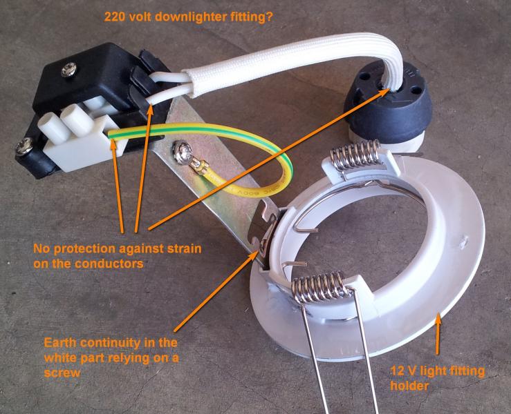

                        I have seen an adapter, which I don't like, that houses a shrouded connection block and a connector for an earth connection which also connects it own metal parts to the earth. This then inserts into the 12volt holder, loosely. I keep failing them and am not sure if they are legal.

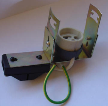

                        This one with also has a method of attaching the 12volt holder via the springs

                        Are these legal?
                          • 4927
                          I'd have to say I think the top one is probably legal. I don't have a problem with the earth continuity via the screw you highlighted. As far as strain relief goes it looks like the connector top shroud provides at least some, strain relief on the lampholder side is usually provided by the internal crimp connection which has two crimped parts, one on the wire and one on the insulation (if you look closely at the lug on the earth you can see the type of crimp I'm talking about). The arrangement in the bottom photo looks a little dicey to me, I'm not convinced that the mechanical connection via the springs would provide good enough earth continuity onto the ring itself. To be honest, if they had SABSapproval stamped on them I'd probably give them both a pass.

                            The top one is 12volt & the bottom one is 220volt. My concern with both is the too short, too thin heat-resistant wire on the lampholder.
                              Although the top one uses a 12 volt lamp holder it is sold as a 220 volt fitting. Interesting point about the short wire.
