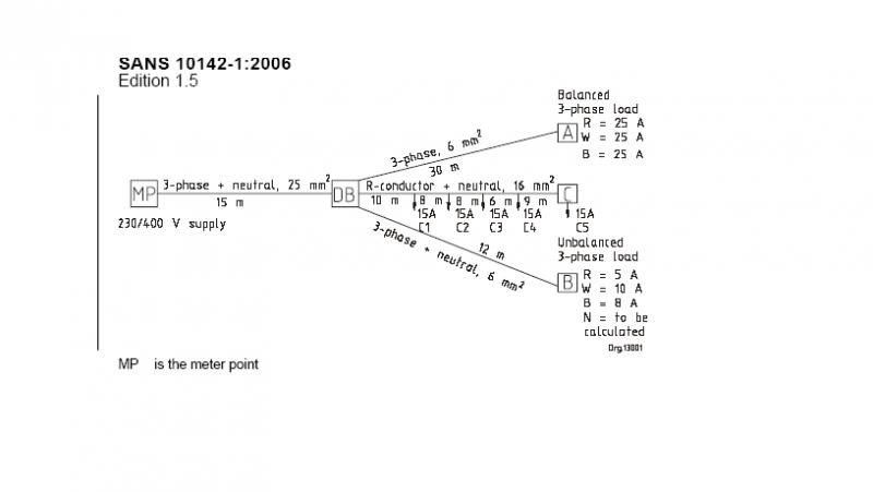

      Am a bit confused here regarding Voltage drop calculation,
Name:	Voltage drop calculations.jpg
      E.1.4 Circuit DB/C
      Selected cable voltage drop to be repeated for each load point from the
      previous load point. Amdt 5
      From table 6.4(b) (voltage drop), for a 16 mm2 two-core cable single-phase a.c., the voltage drop is 2,8 mV/A/m
      DB to C1 voltage drop = (2,8 x 10-3) x (5 x 15) x 10 = 2,10 V Amdt 5
      C1 to C2 voltage drop = (2,8 x 10-3) x (4 x 15) x 8 = 1,34 V Amdt 5
      C2 to C3 voltage drop = (2,8 x 10-3) x (3 x 15) x 8 = 1,01 V Amdt 5
      C3 to C4 voltage drop = (2,8 x 10-3) x (2 x 15) x 6 = 0,50 V Amdt 5
      C4 to C5 voltage drop = (2,8 x 10-3) x (1 x 15) x 9 = 0,38 V Amdt 5
      Total voltage drop DB to C5 (red phase) = 5,33 V [1] Amdt 5
      My question is: why should they multiple the current by 5 at C1, by 4 at C2, by 3 at C3, by 2 at C4 and by 1 and C5.
      is this really right?
      My total voltage drop is 1.722V
      Last edited by Dave A; 14-Mar-13, 08:25 PM. Reason: formatted superscript in formula
        • 22820
        Point C1 is carrying 5 x 15A draw points, 1 at C1 and another 4 further down the line.
        Similarly C2 is carrying 4 x 15A draw points.
        From a "follow the logic" point of view, it might have been better if they started the point numbering from the furtherest point and worked back towards the supply point for these sorts of schematics. Of course from a signage point of view (if you were actually physically labelling each point) it makes more sense to number from point of supply...
