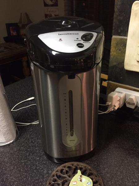

      Hi Andy. Tevo used to do a Kettle, Brand Name Bennett Read Smart Flask. These were available in 6,8 litres & 4,8 Litres.
      Power consumption 750w. Thet were also well insulated and kept water just under boiling point.
      Unfortunately they do not sell them anymore.

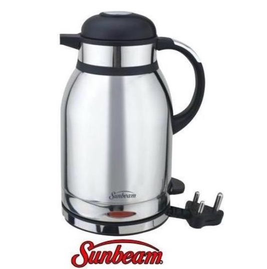

      I found a 1,5 litre Kettle with double stainless steel wall, which also keeps water hot for up to 4 hours.
      Make is Sunbeam. Power consumption 1350w. Available at Makro @ R299.00

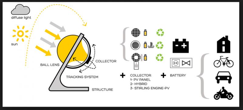

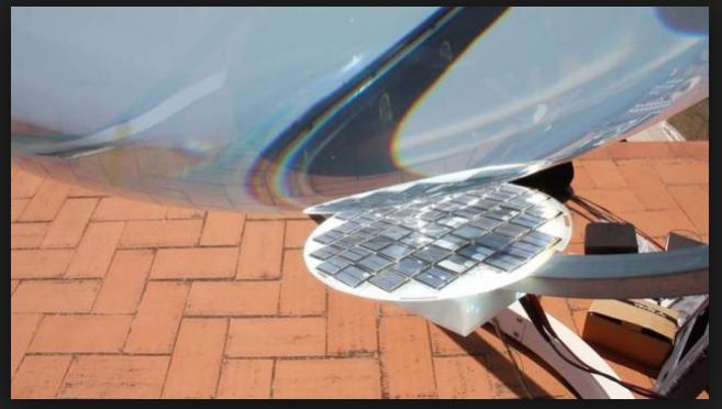

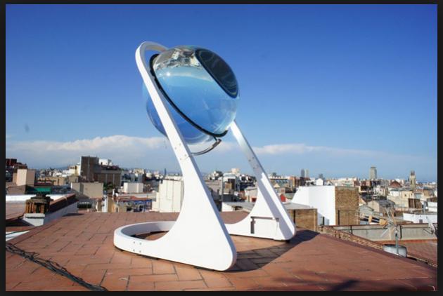

                    a while back friend of mine installed a solar system but it got vandalized as the thief tried to remove the panel. About R20K worth of panels was vandalized. Eventually they took the system off and sold it as they couldn't be at home 24/7 protecting it. My thinking now is, is it worth it? It is expensive and not something one could hide. Now before the demigods spew out there filth it is worth nothing that these types of thefts happen all the time on most farming communities along with generator theft.
                    Knowing this i started to Google for smaller solutions as one can put them under lock and key if the need is there. This is what i found.
