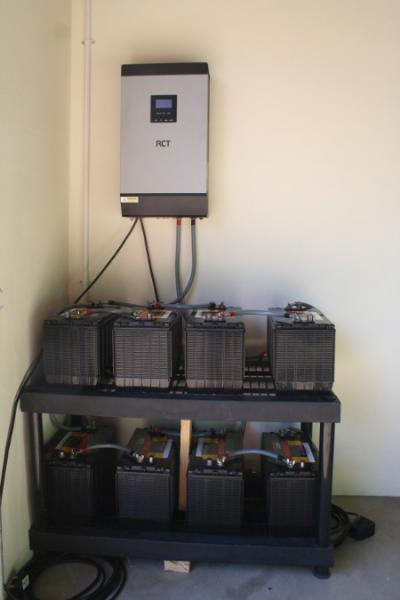

                Hi guys
                I have been following this thread with great interest, thanks mostly to AndyD...
                I am installing one of this RCT 5000, so far the install is:
                RCT 5000W Axpert Hybrid Inverter
                8 Royal 100Ah Deep Cycle batteries - could not get the 200Ah
                Cables to connect the batteries to each other and Inverter - rather more expensive than I thought (R700 with fuse)
                100Amp DC fuse for the battery bank
                Nothing installed yet, but here is my idea:
                The batteries connected with 2 parallel connected sets of 4 in series (basically 12Vx4=48V and then in parallel to the other 4x12V=48V giving me 48V at 200Ah)
                Now my question is now the solar panels:
                I am looking at the ArtSolar Pinetown Durban produced 250W panels at around R2100 excluding VAT vs the SolarWorlds 260W at R2800 ex VAT. It would be great to hear if somebody is using this locally produced solar panel and how it performs.

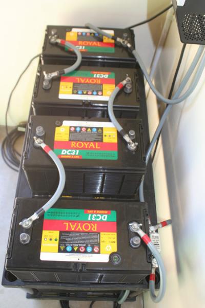

                        A question:
                        I have used a 100amp fuse on each bank of 4 x 100Ah batteries - is this an overkill?
                        And I see the manual mentions that you should have a manual switch for the batteries from the inverter - is this necessary?
