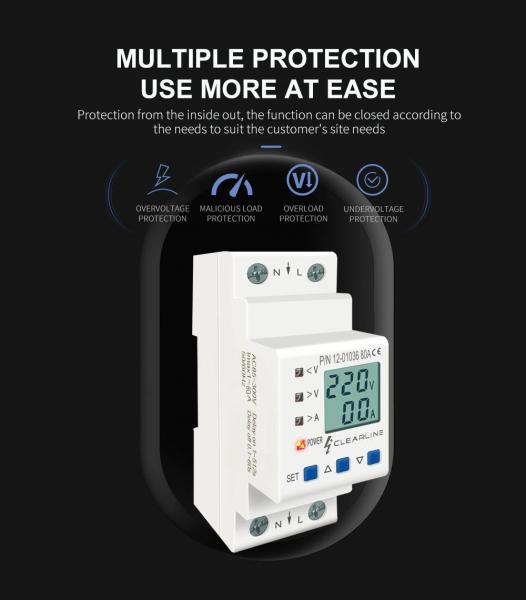

So I contacted clearline to ask about the time delay settings on the Trip-Connect 1F unit - its 10 sec or 5 minutes only, the tech guy mentioned that there is a newer programmable unit that will not require a contactor either, so I have ordered that instead. Will also fit better in the little space left in the db.
Features: - Over current protection, over voltage protection, under voltage protection can disable one , two or three of them. - Voltage and Current Accuracy 0.5% - It’s own power consumption
Just to update. I installed the above unit last week and everything is working 100% now. No more trips when load shedding ends and no having to wake up at 2/4am to switch the power back on.So I contacted clearline to ask about the time delay settings on the Trip-Connect 1F unit - its 10 sec or 5 minutes only, the tech guy mentioned that there is a newer programmable unit that will not require a contactor either, so I have ordered that instead. Will also fit better in the little space left in the db.
