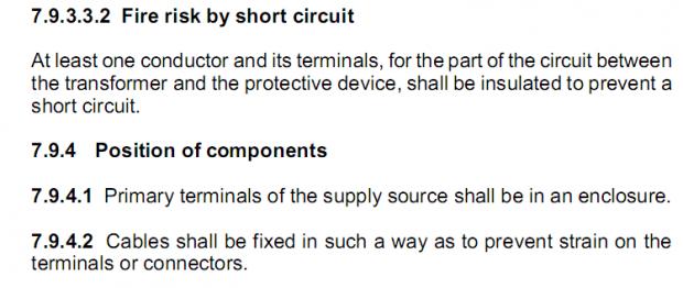

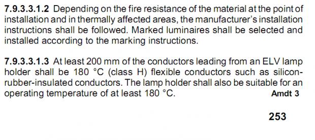

              SANS 10142-1:2009
ID:	261147Click image for larger version

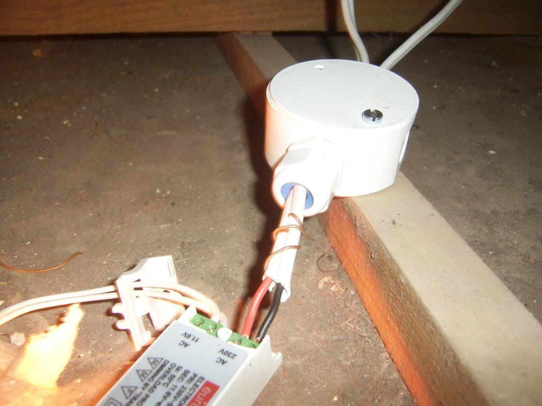

                Cancel that. It's been the length of mains side transformer tails that we've found as a pretty common issue on new installations.
                Sorry for the confusion.
                • murdock
                  • Oct 2007
                  • 2346
                  light points and open/exposed wires...this is another who thread on its own?
                  connecting 2 pieces of twin&e into the primary side of the transfomer?
                    • 22812
                    Comments anyone?

                    • murdock
                      • Oct 2007
                      • 2346
                      better than most i see on a daily basis...i have just finished a...what started out as a little job just to fit 3 lights and connect an ectractor fan....turned into a total rewire of the kitchen...and as the customer always says....but i dont understand it has worked for years....the kitchen was done years ago and the kitchen people got their electrician to wire all the lights and plugs.
