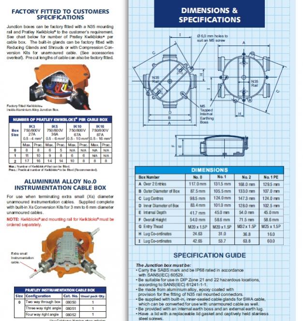

                              So you can get 3 core and earth?
                              Its used in the uk for 2 way or intermediate switches also for linking smoke detectors,you can get it in 1.0mm or 1.5mm handy to have.
                              Speaking about joint boxs,whats the best to use?as i miss the 5A,15A,30A and ashley JB we use to use,using metal boxs or conduit boxs is not the best.
                                #45
                                Not sure exactly what you're looking for but maybe the Pratley range will help?
