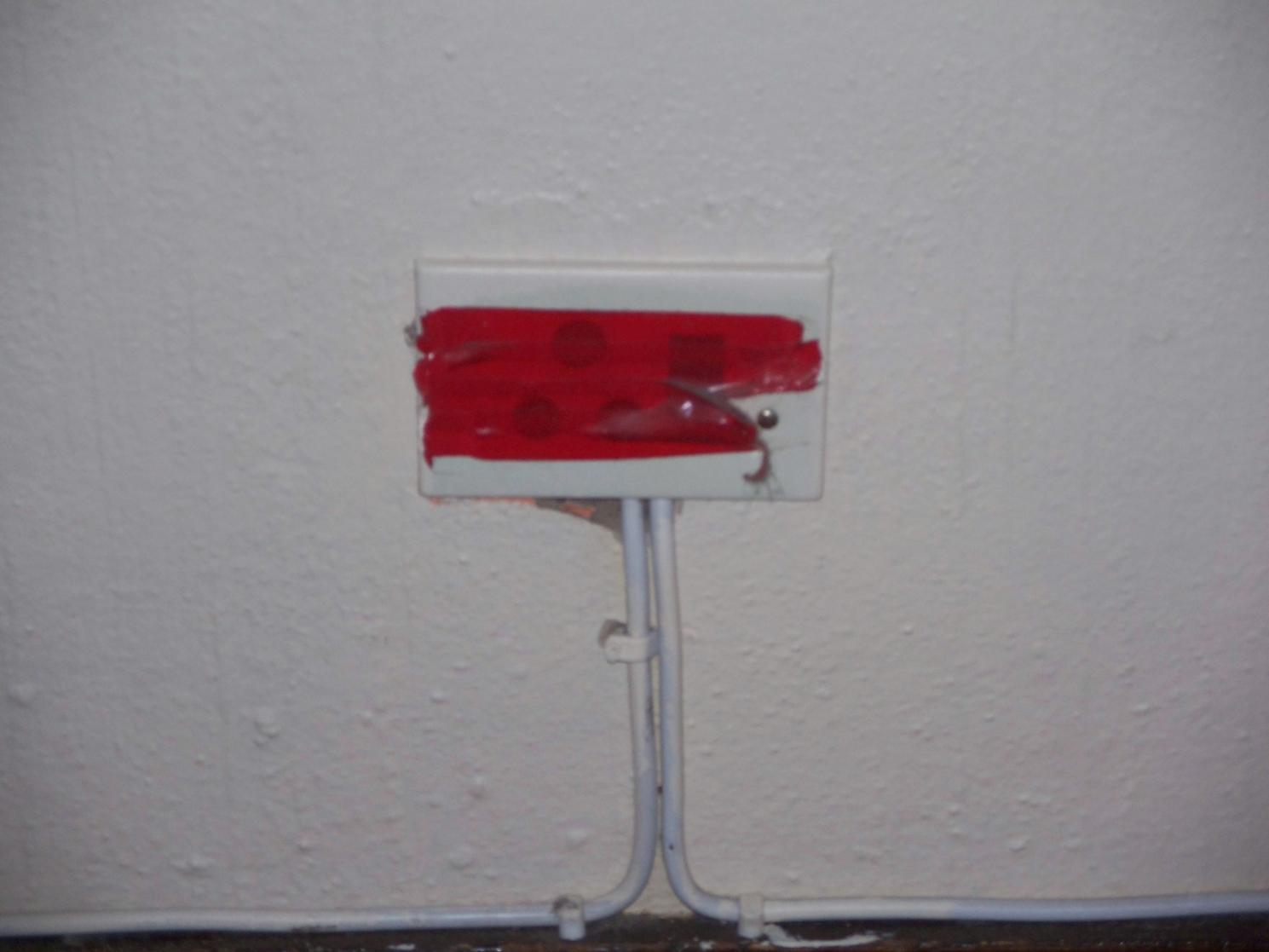

        A sample of what the COC was issued for:
        That is cabtire feeding other socket outlets.
                      Here's that picture
                      And yes, now I understand why Sparks is getting hot under the collar on this one.
